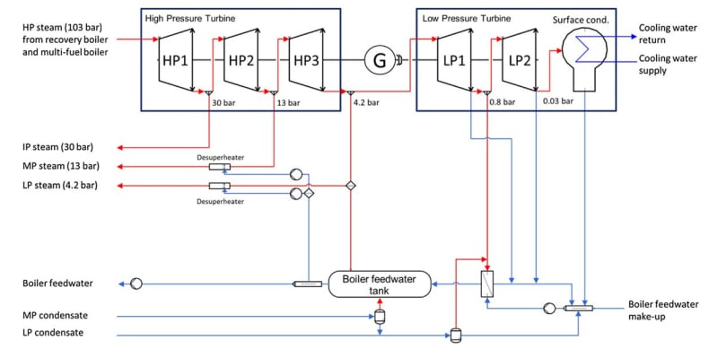

We could not replicate the paper claims. It seems to us that the paper has tried to maximize the electricity generation.
Is it feasible to have steam turbine outlet at 0.8 Bar(a). And have a condenser after that?
Aspen plus gave us Dew point error which is obvious.
They claimed,
"The steam turbine assumed in this study is a conventional back-pressure/extraction turbine and a condensing turbine in dual casing configuration. The steam turbine consists of a high pressure (HP)turbine casing and a low pressure (LP) turbine casing separated bya generator. Both turbine sections work on the same, single shaft arrangement to the generator. HP steam from the recovery boilerand multi-fuel boiler is delivered to the HP turbine inlet at 505◦C and 103 bar(a).The HP turbine offers three different steam extraction points:intermediate pressure (IP) steam at 30 bar(a)/352◦C (mainly forsoot blowing), medium pressure (MP) steam at 13 bar(a)/200◦C(mainly for pulp mill processes) and LP steam at 4.2 bar(a)/154◦C(for miscellaneous pulp and board processes). In the LP turbine,0.8 bar(a) steam is extracted for preheating the boiler feed water.Excess LP steam is expanded and condensed at 0.03 bar(a). A simplified diagram of the steam turbine configuration is presented in Fig. 5." (Attached Figure.
Aspen Plus file attached Attached File PPI_steam (1).bkp 199.52KB 0 downloads
Paper Link
