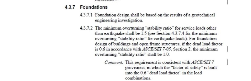

I am working on designing a foundation for a jib crane. [highlight #FCE94F]The jib crane is 16 ft tall with a 24 ft cantilever arm. The maximum lifting capacity of the crane is 3 tons.[/highlight]
From CRSI Design Handbook 2008, it mentions to use a Factor of Safety (FOS) of 2.0 for Overturning, see image:
A FOS of 2.0 is also mentioned in Principles of Foundation Engineering, 8th Edition by Braja M. Das:
However, it seems PIP mentions the use of FOS = 1.5 or 1.2 for overturning, see images:
The only explanation to these various FOS I could find is mentioned in the Foundation and Anchor Design Guide for Metal Building System by Alexander Newman:
For my particular situation, what would be the appropriate FOS for overturning to use for a jib crane foundation based on the crane description I provided above?
I am inclined to use FOSoverturning=2.0, but I would like to have justification for my design which ever route I go.
Comments/suggestions are appreciated.

Minimum F.S. 1.5 mentioned in ( PIP STC01015 Structural Design Criteria ) . The snap is below..
-The vertical weight of the jib crane will be included ..If the vendor provided the overturning moment & vertical weight of the jib crane , If the OT moment provided is based on capacity , plus a hoist & trolley allowance , add and an impact allowance (1.25) and wind effect. Vendor could not know if the installation is indoor or not and the wind load applicable at a specific case.
- If the criteria is F.S. > 1.5 , you may choose the dimensions of the ftg so that F.S. say 2.155 > 1.5 . ( still almost everybody look that the criteria is F.S. > 1.5 . (this clue is my personnel opinion ..)..
- Section 12 is for seismic design and clause ( 12.13.4 Reduction of Foundation Overturning ) is for the structures designed with (Section 12.8) .. and the jib crane is essentially inverted pendulum.. Moreover, the lifted load is not included for horizontal seismic load effects.
- I screened your previous responds and suggest you to ask the supervision of senior structural engineer..
