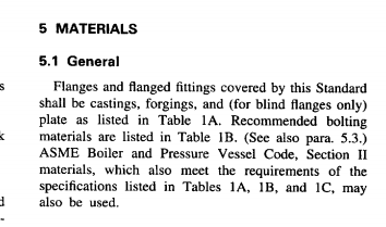

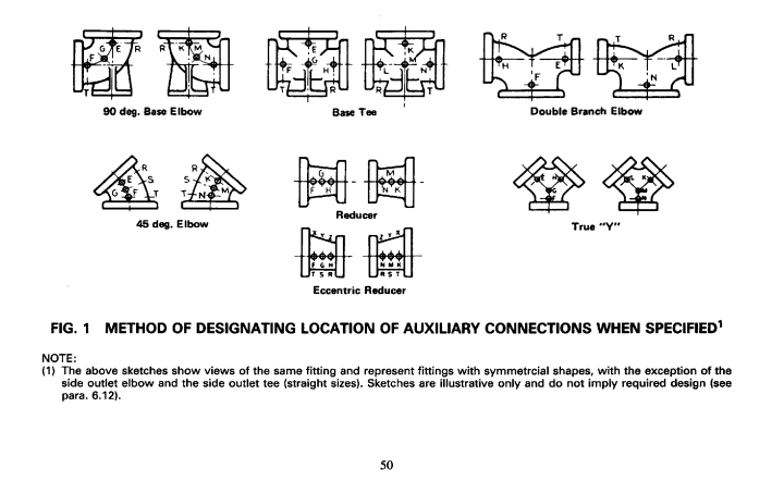

Double branch connection in B 16.5
Materials in B 16.5
Regarding Cl. 304.7.2 it is clear that calculation has to be done. Sec VIII -2 is an excellent basis for calculations. These calculations needs to be substantiated (or validated). One option for this is from by past operating data of similar component at similar service conditions. Of course there are other options for substantiation of calculation.

I think I understand what youre trying to get at, but (the way I understand) B16.5 is that sees such double branch elbows as an integral item. What the OP has done is fabricate something from several parts and attached falnges to it, which imo is something different than what B16.5 intends.
