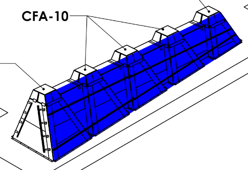

Hello all you concrete form experts!
First form design here for a valued client, so I can't say no. The forms will be fabricated from sheet steel, to pour a ~ 43-ft long concrete mass varying from 6'-10" high to 3'-4". See attached sketch cross section.
A couple of rookie questions:
-I think I have to assume the lateral pressure from the concrete as normal to the form surfaces; so there will be fairly significant uplift due to the sloped forms? They are being erected on an existing slab, and will be fastened at the base with xxx anchors at xxx spacing.
-There will be kinda-sorta steel angle walers along the length, sloping as the form decreases in height. I'm told internal ties are not an option, so I'm left with bracing. If I'm pinned at the bottom slab connection, and the two sides of the form are connected with straps at the top can I possibly use walers along the height of the form at whatever interval is required? I'm thinking with the non-symmetrical angles on the two sides I will have a net force one way trying to push the form over?
-Any other words of wisdom to kick my design off on the right foot?
Thanks in advance!
 https://files.engineering.com/getfile.aspx?folder=74e8de92-54ec-4b7f-a69f-fb49fd7a9011&file=form.PNG
Keep your deflections small.
If you have no control over the pour rate, then design for full liquid pressure.
Get a copy of ACI 347R (Guide to Formwork for Concrete), as well as a copy of "Formwork for Concrete".
This is a tough scenario - the uplift is no joke. Free-body diagrams are your friend.
That is an incorrect thought*, though I can see how initially you could conclude that.
**unless there is another form item in the 3rd dimension not shown.
Integrate the pressure around any horizontal slice and you will get zero. (assuming the form is a closure section) If this wasn't the case then a oddly shaped cup filled will water would accelerate sideways! Another way of looking at it is there nothing to produce a horizontal reaction apart from the form, so it must sum to zero.
Though as WinelandV pointed out uplift is not joke here. The ground reaction is the quite rude!
Yes uplift is certainly an issue here because of the slanting faces, and so many experienced people do not consider it until it happens. I had it happen to me in my younger days on one sided forms.
Agree with Human909 that sum of the horizontal pressures sum to zero, but integrating the upward component of the pressure leads to the upwards force and this has to be tied down.

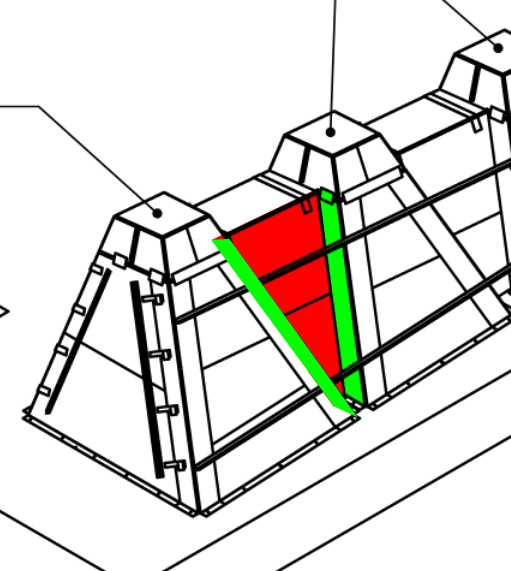

Looking at the desired shape, I dislike everything about this.
Yes, if they try to pour this all in one go, the high end will have more horizontal pressure than the low end. However, you should be able to contain those forces w/in the long sides of the forms - but that will be hard from a computation and detailing perspective..
I think you're better off designing each of the 4 sides to be stable in itself. Yes, this will require an external brace (or two, or 6). You'll still need to seal up the corners, but you won't be depending on those corners to keep this thing contained.
The saw-tooth effect in the long sides looks nice, but is going to be a nightmare for your formwork. I would design the long sides assuming it's all in one plane, and then have your fabricator weld trapezoidal steel boxes (w/internal stiffeners as req'd) directly to the plane.
Design plane for the long side:
Possible internal plates to make the shape:
@WinelandV, I don't disagree. But this a good client that I can't pick and choose projects with so I have to help them thru it.
What you see is what you get (as currently designed); the forms are 10ga sheet steel panels that are going to be fabricated with all the in's and outs, tapers, decreasing heights etc. The sides are two pieces of weldment, stitch welded together in the field and the ends are panels with toggle latches. I have to tell them what additional straps, bracing, walers, fasteners etc., are required to keep it all together.
