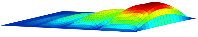

The real (but already at the export reduced) data set is a lot bigger and has a total of round about 2500 rows. I reduced it further to show the concept without posting that much code. It shows the deformend geometry of a shell.
The point of exporting it like this in LaTeX is that, when the "slices" are equally long, a structured mesh can be generated by LaTeX. This is shown here:
The picture is originally a scalable vector graphic in my LaTeX document / the output .pdf. The shown surface is as already mentioned also a reduces one, where only every fifth node is shown in the direction of the multiple buckles. My intention is to show more nodes / elements to better approximate the steep walls, like the one on the right side.
Therefore I'm still interrested in exporting the vector graphic from APDL directly or expand the memory which is available.
Are the colors added just based on height?
The problem I foresee is that every scalable format will be carrying a large amount of floating point representation and if you are having trouble with a point cloud, then SVG, et al, won't improve the situation.
After it's in the document can the user scale the graphics or make measurements from them?
The colors are added based on height, that's right.

But one big advantage of the way I'm doing it right now is, that it's possibile to rotate the surface before plotting it on the PDF even after exporting if from APDL.
