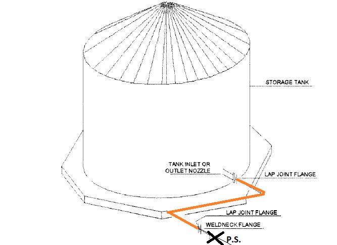

What about for the use of lap joint flange with zig -zag spool ?

Hturk,
That's good for the initial fit up as it allows you to fit the pipework to match the elevations. However it then gets welded in place so when the tank settles which is what the OP is talking about it doesn't move and puts forces on the nozzle.
Having said that the Zig zag spool piece will reduce loads and add a lot of flexibility so might be a good idea for the OP.
I agree with HTURTAK ..... with some reservations
But I disagree with Littleinch ..... Some rotation will exist at the faces of the lap-joint flanges which will mitigate the tank settlement.
HURTAK's scheme will work only with lap-joint flanges, not other types
However, the owner must periodically monitor the lap-joint flanges for leakage as the tank settles ..
Any body else ???
MJCronin
Sr. Process Engineer
I have edited my post ... Assume we have a PS at location shown with X and assume the tank experience a substantial amount of settlement ( say 100 mm) .. If the outlet pipe size is small , with the zig zag spool , the settlement could be compensated with flexibility of piping..
However, if the pipe size is large enough , the zig zag spool will exert abnormal torsion to the tank outlet nozzle and remaining piping .
In case of the use of LAP JOINT FLANGE, the torsion effect will be reduced with the friction failure of back -up flange and gasket..
Mr CRONIN, i just see your post .since i was writing my respond.. But i fully agree for the monitoring of the lap joint flange but in case of substantial settlement, may be just extra tightening of the bolts could stop if there is small leak. Bu a pink star for your comment..
MJC - I must admit you might be right in practice, but I've never seen torsional slip of a bolted flange being used as a stress relieving measure.
But yes, in essence what we've been trying to tell the OP is that there are other ways to accommodate the tank settlement, but tbh, I wouldn't be building tanks I expected to settle by more than 50mm. settlement is rarely even across the tank and you need to fix the foundation, not the pipework...
