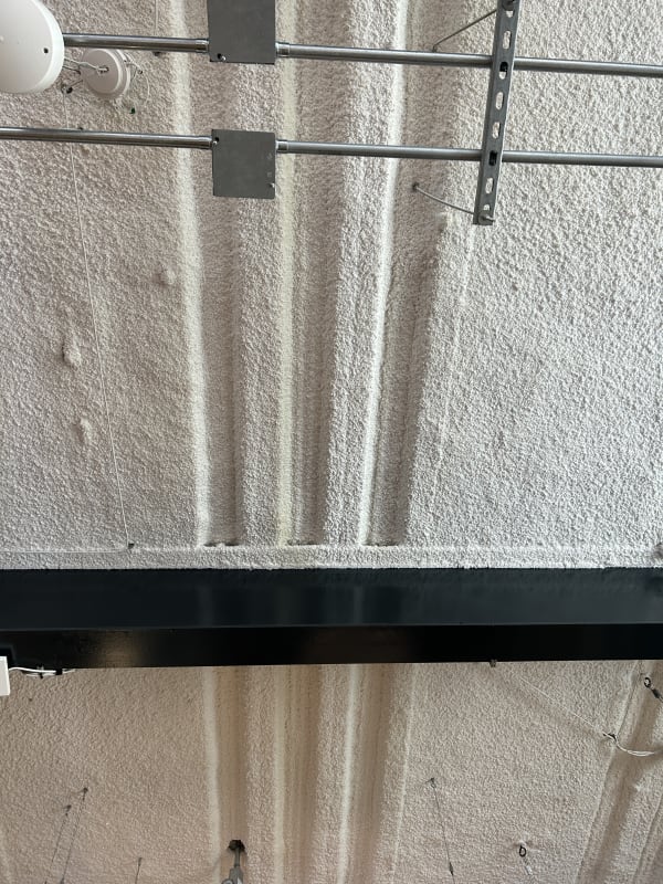

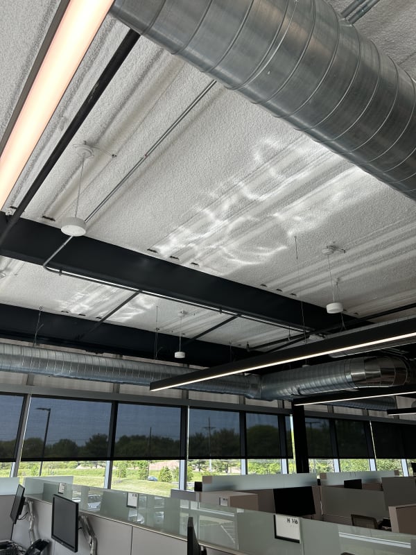

Came across this odd deck configuration in the field while surveying an existing building. Does anyone have any idea what deck type this may be?

Where built? When built?
Is that deck covered with a membrane or built-up roof?
That looks more like a light gage metal siding vs. a roof deck.
JAE,
Mid-North NJ and it was constructed in the mid 1980s. There is a floor above and the deck thickness is about 2". We tried to get into an existing core to get the overall depth but a plug did not allow us to get the final depth; we are estimating 4" total thickness (2" deck; 2" topping; fire rating N/A due to the fireproofing) based on what information we could grab. Some additional information is this is an office building and the deck spans 10'-0".

Check out this older Inryco Deck Catalog. Not sure if this is what you actually have but it shows how some cells are covered with a bottom cover plate to provide runs for electrical lines, etc.
This is a 1973 catalog so a bit earlier than your building.
I think this is what you have - some combination of open and covered deck.
