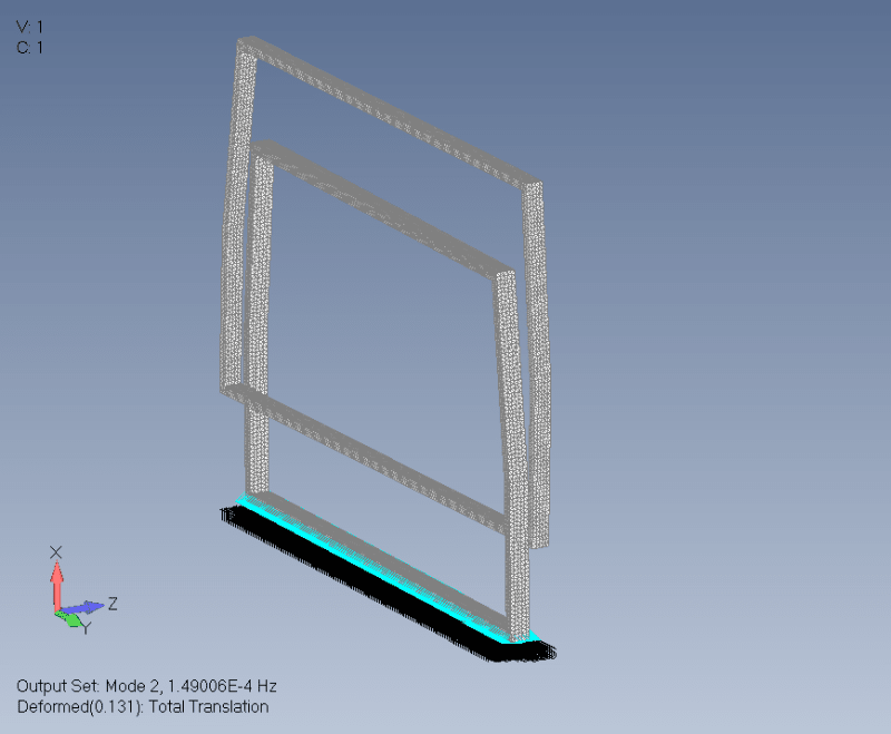

Hello, I have this simulation attached.
It is a frame and it is shell meshed. However I am struggling to run a simulation on it because I always get an excessive pivot ratios error. I have tried running Bailout -1 but to no help. Could not figure out where the error is.

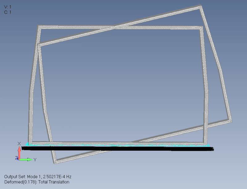

Look like your model is poorly constrained, run sol 103 (modal) and check first near zero modes. Fine constraint model should not have them. You can check deformed shapes to see what parts of model not connected to whole structure.

I think the elements are plane strain elements (MID2 is set to -1 which is plane strain) - in PSHELL MID2 set it to 1 for MAT1 and it will be a mem.+/bending shell element- also the inner and outer tubes/sections are not connected with each other - as suggested run a modal analysis and you will see that (since there is a restrain on the outer section only) the inner part/tube is "flying" away. If this is a RHS/SHS you only need the one of the two tube sections (either outer or inner, but not both) Hope this helps.
You have Two plate parts. Outer part is constrained but inner part is neither constrained nor connected to outer part. So, it not constrained and can move free. In addition, plane strain elements don’t have stiffness in all directions (I delete inner part, run normal modes and have one rigid mode) so I recommend to use general plate elements, unless you are know what you are doing.

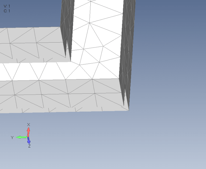

I was unaware that I had created two 2D-mesh frames.

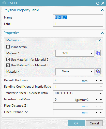

Attached here is the geometry I really wanted to simulate. Also, I have now managed to solve it using Erik Panos tips for PSHELL1.
I only have few question left then, what happens in PSHELL1 when Material 4 is left blank? And is it correct of me to define material for both MID2(Material 2) and MID3 (Material 3)?
Great forum!
I think that is OK - MAT4 is for bending-membrane coupling which can occur if material prop. say are are not symmetric with respect to the midsurface of the shell.
Here is something from the documentation:
The MID4 field should be left blank if the material properties are symmetric with respect to the mid-surface of the shell. If the element centerline is offset from the plane of the grid points but the material properties are symmetric, the preferred method for modeling the offset is by use of the ZOFFS field on the connection entry. Although the MID4 field may be used for this purpose, it may produce ill-conditioned stiffness matrices (negative terms on factor diagonal) if done incorrectly.
