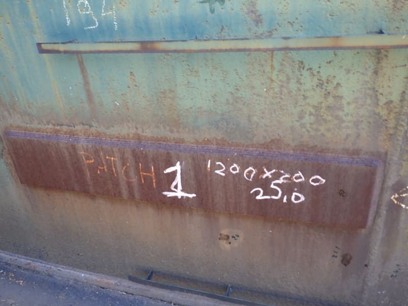

OK, so here is a picture of an example of a patch installed on the lower shell course, used to close former shell openings of 2 in.
I don't have pictures of the internal side, but the inside is welded as well.
This patch LxWxt = 1200x200x25 mm, installed on a shell thickness of 19.4mm In inches: ~ 47 ¹/₄" x 7 ⁷/₈" x 1", installed on a ³/₄" thick shell plate.
Because 'plate thickness limits need not apply' on existing patches, this plate is acceptable (except for the lack of rounded corners).
A new patch is not allowed due to shell thickness > 1/2 in. An insert would be required.
Did you calculate the required thickness of the patch using 70% joint efficiency?
Did you check the weld spacing to the corner weld or what looks like a shell butt weld on the right?
