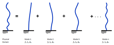

The effect make be accurate. You are, after all, doing the RSA in part to capture vibration modes higher than the first.
I think KootK nailed it. It looks like you have an inflection point around level 12. Squint your eyes and look at mode 3 below.
Also, curious do you have a podium around level 5? It looks like a big change in stiffness.
This is also one of the reasons why RSA results often have to get "scaled" back up to some percentage of the equivalent lateral force base shear.
Shouldn't you generally expect greater storey shear forces at the top? Kootk and Harbringer80 have touch on the reasons why. Other more simplistic codified approaches allocate higher percentages of the base shear to higher floors than lower floors.
