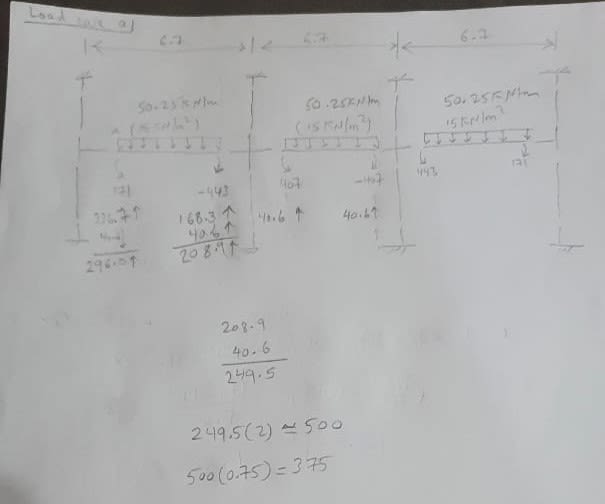

Hi all,
I tried to find out column axial load for Example 13.3 in Nilson's Design of Concrete Structures textbook, SI units, 14th so I can compare it with Autodesk Robot Structural Analysis.
Please find attached link:
Robot results 335.71kN
My hand calculation results: 375kN
Is it comparable? Is my hand calculation correct?

Please find the attached link:
I think it's comparable with Robot results.
 https://files.engineering.com/getfile.aspx?folder=7ab20ae0-3504-48ea-93f3-7670e73100b2&file=Column_axial_load.jpg
I believe your updated calculation is the shear in the slab if so the column reaction would be the difference in shear between two bays which based on the numbers you show would be around 713+/- Kn.
Are you sure you are comparing the same applied loading between the two analysis.
Also note that the Equivalent Frame Method is a 2D frame model of the 3D structure so there is an overlapping load region, typically you would do tributary area for the column axial load. Assuming this is a regular grid then by tributary area you would get around 6.7m * 6.7m * 15 Kn/m^2 = 673.35 Kn, based on this your loading or support conditions in Robot may not be correct.
In your robot model make sure the support condition for the columns above the slab allows for vertical movement otherwise they will act as hanging supports.
The image reference your posted from SPSlab is for a single span your interior column is supporting two spans you must add the the shear from the two spans to get the total reaction at the support this follows from statics/ mechanics of materials.

Here is the results with 15 Kn/m^2 over the whole slab with the top supports corrected from the model you posted in the Robot Forums:
Interior Column Axial load = 772.42 Kn, this is larger than the tributary area results due to 3-Dimensional continuity and axial shortening of the columns (EFM of the example problem does not account for axial shortening)

See also this quick static proof of the interior reaction of the 2D frame model:
