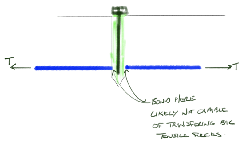

A situation has arisen where the foundation installer cannot tell us where the rebar is, and the foundation engineer forbids us from drilling thru the rebar if we encounter it. (when we encounter it).
I'm sure in the past, we ended up drilling thru the rebar more often than I should admit... and its never been a problem (yet?)
I feel that if one drills thru (basically cuts) the bar, the combined presence of the steel anchor and the epoxy material "re-creates" the continuity of the bar.
I recognize the shear strength of the epoxy is less than the rebar steel, but the Epoxy is usually stronger than the anchors... so....

Force in the rebar is generally tension epoxy touching just the exposed end of the bar will not be adequate to transfer the tension between the bar ends. In general you should never be cutting or damaging the reinforcement without explicit direction of being allowed to do so by the EOR.
Open Source Structural Applications:
It's typically not the shear or compression strength of the rebar that is needed - it's the tension strength, which will not be mitigated by the epoxy. A bar that is drilled through is discontinuous and not effective for transferring tension. If the rebar is required to provide tensile resistance at the drilling location, it will have to be avoided.
Hell no. The bar is shot for tension. As the other guys have mentioned, there's just no way that you'll be able to develop the cut segments of bar into the epoxy sufficiently. Other comments:
1) A good foundation designer would have designed the foundation such that a couple of bars could be sacrificed if need be.
2) In the absence of #1, I guess you've got to scan the rebar and, if necessary, create a custom base plate that dodges it.
3) If it's appropriate for your situation, you can sometimes do some creative slotting of the base plate holes to make the odds of being forced to hit rebar very low with a stock base plate. This may still require scanning, however, as you probably don't want abandoned holes near your final hole.
