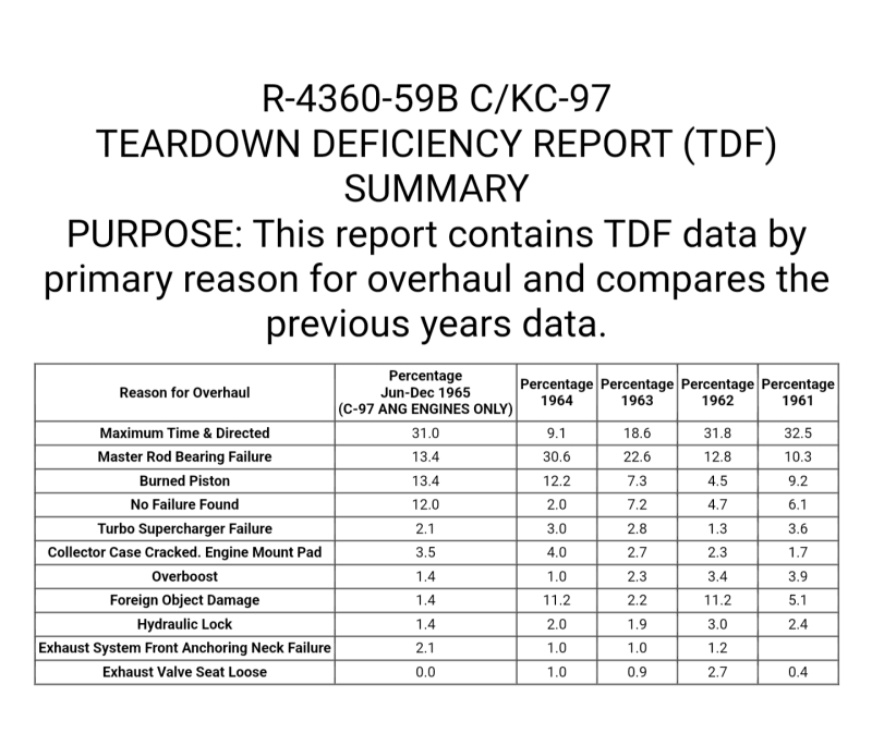

Meanwhile, check out this table for the R-4360 in a fleet of C97 aircraft. It shows in 1965 that only 12% of engines didn't have failures within their overhaul period.
You're doing well if you get to 1500 hours between overhaul.
So turbine engines require far fewer overhauls. Also, a turbine engine can do the work of 3+ of the largest recip engines which improves economy even more.

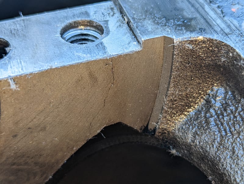

Funny story, my personal truck has an engine with a known problem. The main bearing webs crack at the outer bolt holes. The cracks eventually propagate into the water jacket. I like this example because the thicker fatter stronger aftermarket has always suggested solutions that never worked. In 2001 GM gave the molds to International to continue production. International's solution was to reduce the diameter of the outer main cap bolts from 12mm to 10mm and that solved a 20 year long issue with cracks.
Tugboat, what engine? So they essentially added more material to that area? Less clamping force?
Fuel burn ~ emissions, so I'd say its safe to assume aircraft and autos will both continue in the direction of less is gooder.
GM 6.2/6.5 diesel. No material added, they reduced the size of the bolts.
Effectively, material WAS added since the pilot drill for the 10mm tapped holes removed less material than did the pilot drill for the 12mm tapped holes.

This was supposed to be my weekend project but apparently it's illegal to buy a camshaft bearing tool in California and I messed up the first bearing with my homemade tool.
Anyways first pic is my dead 6.2 block. Second pick is updated 6.5 block with smaller boots on the 3 center main caps.
Do note that the first engine was removed from service due to head gasket failure and that these cracks did not cause issues when running.
