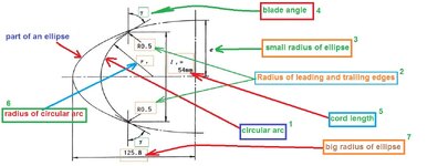

my model is a Turbine blade profile.
We have the following 7 dimensions(Considering to bellow attachment)
attention that blade angle Pass from Middle of leading and trailing
edges radius.
When designing, Why is there a extra dimension?
In other words,with these dimensions were create a Bounden form..
one of dimensions is not apply...why?..There is no way?
Now, what am I doing for designing this Turbine blade profile?
Whatever I do, will not be true.
Thanks for you help me.
