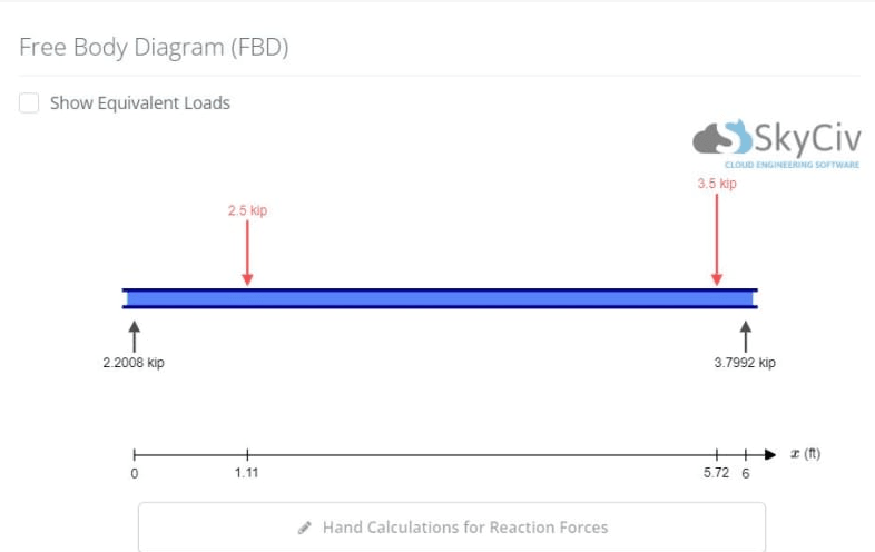

Here is a typical block up elevator machine arrangement with car and counterweight. The car is supported by cables that run over the driving machine sheave, onto a deflector sheave (frictionless) and then down to the counterweight. I am trying to find the most accurate way to analyze the reaction forces at the base of the block up assembly (red) acting on the supporting beam (blue). Obviously the car and counterweight cause tension in the cables that travel over both sheaves - where should this tension be applied? A coworker says I can simply idealize the cable tension as a point load directly on the blue beam at the locations they pass the supporting beam.
My instinct says this isnt the proper way to analyze this. I think I need to start by figuring out the reaction forces of the machine and deflector sheave onto the red beam they are both mounted to. However, I run into the problem that the cable tension is unequal from the car side to the counterweight side. I believe the cable tension on either side of the deflector sheave is equal, but the angle of the rope causes a force downward and towards the drive sheave on the deflector. How should I be analyzing the drive sheave? Am I overthinking this?

If the reaction is directly at the pulley shaft, then this
should make sense.

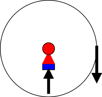

3DDave you are missing the force on the other side of the machine sheave going down to the counterweight. (see below)
Am I correct in saying that for a static situation the reaction at the machine shaft is just a matter of resolving the 2 rope tensions plus the brake torque? Or is there a frictional force (that allows for the difference in rope tensions) that must be taken into account?
For the record - I happen to think that SwinnyGG is correct in saying this is the more accurate way to solve for this, but I also think that the error in rb1957's method is accounted for when we apply FOS before giving these loads to the SEs.
The friction force on the pulley is what is creating the torque - so you can look at it as 'what reaction is required to counter this friction force on the pulley and maintain equilibrium' or you can look at it as 'what's the torque I need to apply to maintain force equivalence once the two tensions are resolved to the single force through the shaft'
Those two approaches wind up in the same place. Either way youve got a force through the shaft and a moment around the shaft which get resolved down to the feet.

I think I'm saying your co-worker is correct.
"A coworker says I can simply idealize the cable tension as a point load directly on the blue beam at the locations they pass the supporting beam."
As far as I can tell, this (from a previous post) looks to be about right ...
mikek396, I did not miss it. I made an example. The pulley vector diagram you made is missing the torque.
