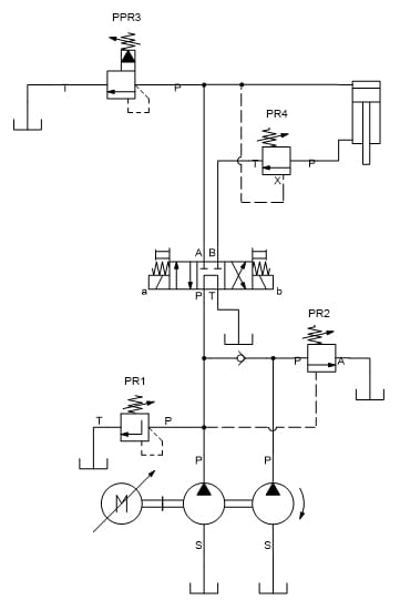

My team is designing a pressure vessel testing machine. This testing machine can be simplified and assumed to be a 120ton hydraulic press with a vertically mounted hydraulic cylinder.
Our goal is to use an HMI to set the force the cylinder shall apply to the test piece. The force range is from 10ton to 120ton. We want the accuracy of the applied force to be +/- 5% of the nominal force set in the HMI. The extension and retraction speed of the cylinder is not relevant.
We are designing the electro-hydraulic circuit for this cylinder and have come across 3 possible solutions to control the pressure on the piston side of the cylinder:
1) Servo directional control valve​
2) Proportional pressure regulator valve​
3) Proportional pressure reducing valve​
We believe that solution 1) will require a control loop with pressure sensor data feedback to the controller (which, considering also the higher cost of the valve, would make this the most expensive solution).
We are looking at existing solutions and usually they use a proportional pressure regulator valve. We don't mind to use a proportional pressure regulator valve but I am trying to understand if a proportional pressure reducing valve would have any advantage, and if not in which applications would a proportional pressure reducing valve be chosen over a proportional pressure regulator valve?
So, in summary my question is: which possible solution is more appropriate for our application?

1. Your design is flawed. Why haven't the others said this?
It has already been acknowledge that there needs to be an opposing force on the rod side. So how does PPR3 control net force?
I posted Net force = Pa*Aa-Pb*Ab.
What is the pressure or opposing force on the rod side? If you do not know you can't control force unless you use a load cell which may be preferred in a clean, low volume test environment.

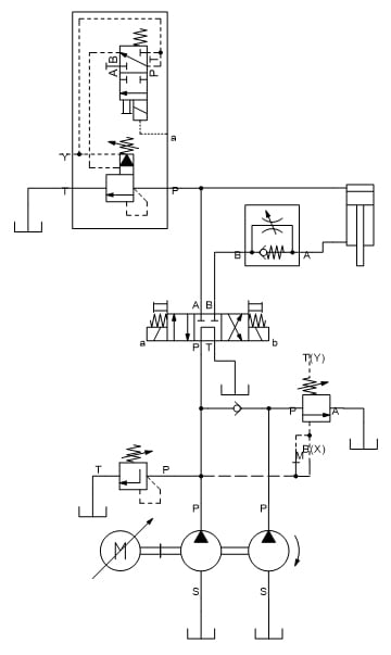

Let's take the last circuit (even though it's missing a few check valves, but please bare with me) with a counterbalance valve as suggested by HPost.
Once the rod touches the workpiece why can't I assume that Pb is 0? The counterbalance valve is fully open and the rod side is connected to tank.
As such can't I calculate the net force the press exerts on the workpiece as Pa*Aa?
Counter balance valve turn on and off outside the control of the motion controller.
Servo control is like the movie "Highlander" there can be only one control valve.
It won't be. It better not be or the press will come down fast due to the force on top and gravity.
You can assume that if you use a directional valve since they will fully open and close. A servo quality valve still needs pressure to force the oil out the rod side. If you open the valves long enough the force can be roughly determined by Pa*Aa but it is what happens in between that will determine if your simple idea will work. Usually servo control systems with rods pointed down chatter on the way down unless the CBV is self piloting. If the CBV is self piloting then there will always be pressure on the rod side. Do you understand why the system will chatter on the way down?
Conceptually I was thinking that PPR3 pressure would be set by discrete increments, i.e.: the operator loads a new piece; sets the type of workpiece on the HMI; presses start; the cylinder extends until the rod touches the workpiece and the pressure could never go above the set pressure of PPR3 (unless the control circuit is badly tuned and allows for overshoot). Then the PLC would increase the set pressure of PPR3 by, for instance, another 10bar, and repeat the previous steps until the clamping force is equal to the value set on the PLC memory for the type of workpiece under test.
You forget about kinetic energy. When the press makes contact with the work piece it is the kinetic energy that matters if there isn't enough kinetic energy then the press's force matters. Since your press doesn't need to be fast I advice a slow closing speed. It be easier to control the force. Still you will not be able to tell what the peak contact force is.
If you do it your way you should monitor the pressure on the rod side too and take that into consideration when stepping up PPR3.

for me i make these schema:
1: gear pump 12l/mn - 0.75kW
2: without leakage on port 1 znd 3 - adjusting 50bar - ratio>4 - with drain
3: piston pump - 0.37kW - 0.6l/mn that mean 60 secondes for go to 250bar with cylinder in middle position
4: electronic pressure switch - cut pump 3 when the pressure is OK - give autorisation to go back when pressure < 3bar
5: adjusting 15bar
6: adjusting 270bar
7: port A up
 https://files.engineering.com/getfile.aspx?folder=fc2159ba-ffa9-45e2-b86e-962c55a934c0&file=presse181017.pdf
