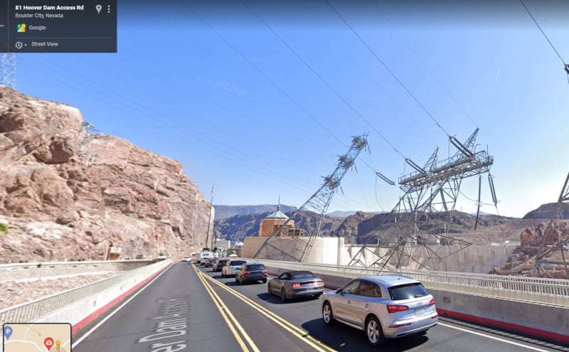

Sometimes near hydroelectric dams the the tower foundations are designed to intentionally lean the tower 30-45 degrees. Here is an example from Hoover dam:
Boundary has other examples of towers leaning over the edge.
is stub angle and tower angle the same thing? It appears they construct the towers inclined from tbe beginning only.
