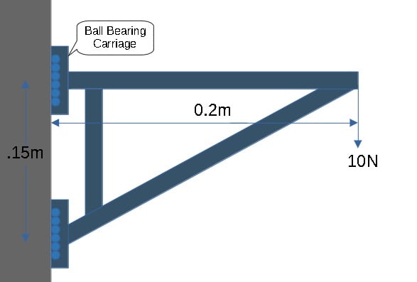

I got question on what is happening to the moment and forces on a ball bearing carriage with a lever arm. Basically the carriage is at rest and is moving/accelerating up and there's a load of 1kg at the end of the lever 0.2m from the carriage.
If it was not moving, the moment about the carriage is 1kg*0.2m=0.2kg*m (static problem), but once the carriage accelerates let's say 2G (gravitation force). I assume moment about the carriage will increase. So can someone explain what is happening once it starts moving and can the moment still be solved if we know the force used to move the carriage, in this case 2G?

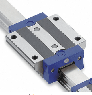

does the blue (horizontal) wrap around the grey (vertical) ? if not, how does the ball bearing resist moment ?

I interpret the picture as an attempt to sketch up one of these.
ok, so there are two races supporting a load to the right (in the pic) ? Then (of course) each race reacts one of the couple forces (compressing against the track).
Yes, the picture is of the bearing rail.
On a similar situation if I add a second carriage and lock them in a bracket as a static problem what is happening to the forces and moment at the top carriage?
At first I thought the moment would be just the same (-10N*.2m)=-2N.m but it doesn't seem right to me, as there's is a force pushing against the lower carriage so there is an moment there also right? Otherwise, the moment about the top carriage would be the same with or without the addition of the lower carriage and addition bracket support.
it'd be clearer (to me at least) to add the rail, so the bearing can react load in two directions.
so, ok, the bearings can react the moment, as a couple but the direct force would accelerate the structure (inertial reaction) since there is no shear loadpath.
and this would reduce the moment into the wall (as the inertial reaction is applied at the CG).
yes, one "carriage" is reacting load to the left, the other to the right, base for couple is now the width of the frame (rather than the width of the bearing race).
This is very simple. If the carriage accelerates at Xg, the applied load is whatever it takes to accelerate the mass on the end of the cantilever at Xg. If you have 1 kg on the end of the cantilever, and you accelerate the bearing at 2G, the load on the end of the cantilever is 20 N due to the acceleration.
With a second carriage in place as you've drawn, assuming the bracket arrangement is relatively stiff or pinned at the connection to the bearings (which is how I'd do it if this was in the real world) neither carriage has an applied moment. The upper carriage is seeing normal load to the left, and the lower carriage is seeing normal load to the right.
By arranging the bearings this way you've dissolved the moment applied by the load into a force couple, both components of which are normal to the bearings. If you look at bearing ratings, you'll notice that for the same bearing, the rating increase if you remove all moment loading is gigantic. Never use linear bearings in situations where they have significant moment load applied if you can help it.

The practical ingredient missing from the first pic is the "fact" that the roller race is inside a track. This allows the bearings to resist the moment as a couple ... one force acting to the left, the other to the right.
