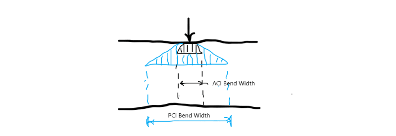

What effective width do you typically design a precast wall for? PCI recommends a width that is 12*thickness + bearing width. ACI recommends 4*thickness + bearing width which is three times as small as PCI's recommendation.
Maybe the difference comes in the first line of ACI's load distribution definition. From ACI318-14, Section 11.2.3.1: Unless otherwise demonstrated by an analysis, the horizontal length of wall considered as effective for resisting each concentrated load shall not exceed the less of the center-to-center distance between loads, and the bearing width plus four times the wall thickness.
Perhaps PCI has performed testing which increases their width to what they recommend but I haven't found much in PCI to justify their recommendation. Fellow engineers at my company stay with ACI's recommendation. We ran a finite analysis using mesh and the results are closer to ACI.
Does anyone know what study PCI did to justify this increase?
