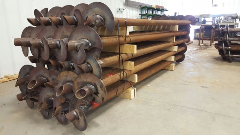

Have you looked for helical anchors?
They may be more readily available than the ones you show.
probably better than no paint...
Can you find some sacrificial zinc blocks to fasten to the shafts?
Some zinc on the screw piles may be a good idea as well.

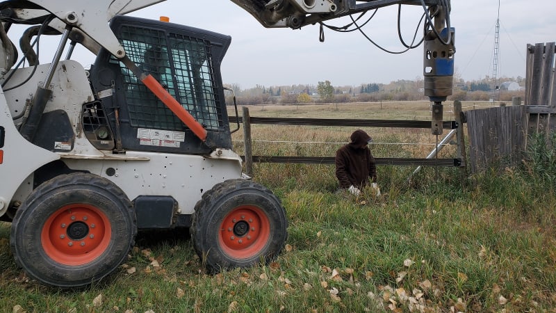

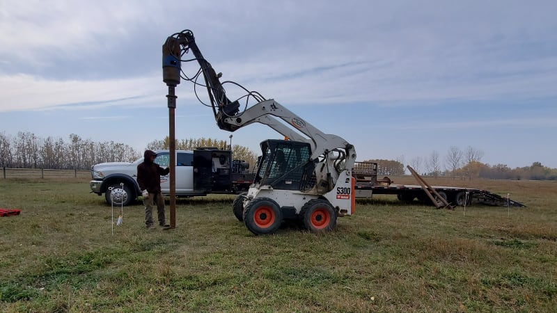

When the contractor arrived, the first thing to do was to remove the old screw-anchors from the previous tower site. They all came up smoothly and examining their condition I was amazed to see very little corrosion. Having 6 removed from the ground + 1 left over that had never been installed, I picked the 4 best for the new site. Installation at the new tower site was easy.
The main reason for the contractor to be there, the structural screw piles for the tower base, went in very smoothly, too. Their installation torque was 15,000 foot-pounds (wow!) so much stronger than I expected. That pushes the load rating up to about 40,000 pounds so I'm looking at a safety factor of about 10!
Not that I'm planning such a thing, but that kind of load rating would make it possible for a future tower upgrade to a completely free-standing tower rather than one with guy wires.
I also just got the bill from the installer of the screw piles. I'm still happy.

Chicken feed... I used screw piles to support six 400,000 lb transformers... now that's a real load. I don't recall what the torque was but it was a lot greater. I'd asked that torque be recorded and they forgot to.

The piles work great. I put piles in for my new deck (walk out basement and roof over it, so needs to be well supported). So much easier than concrete and way quicker.

The guy anchors are installed at 30 degrees from vertical.
There are lots of choices for large screw piles nowadays. I think the advantage is slowly becoming apparent in many places.

Under the deck, yes 4 piles along 36' of deck length 10' away from the house. They guy installed them with a mini-ex, would be similar to that skid-steer rig. I think it was something like 2000 ft-lbs of torque on the 2 holding the roof posts (roof is 24') and 1500 ft-lbs on the other 2. They have a screw on the end, not the entire length.

I'm not sure if these are what Spar used but they are common here in Alberta. Drive by most oilfield service company yards and you will see piles of them.
