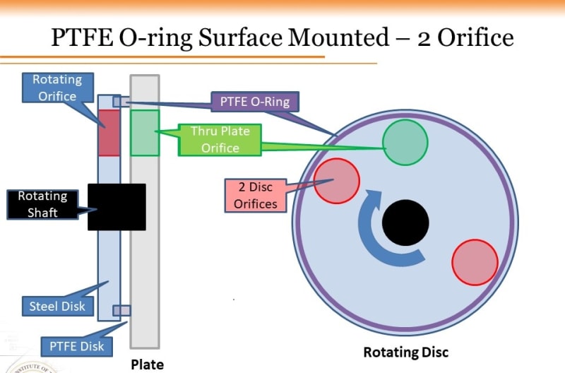

OK I'll try to keep this brief.
I have an application that is meant to diminish (not seal) leakage from a 50-100psi vessel around a 5 inch rotating disc out an orifice. So within the pressure vessel is a 1 inch rotating shaft with a 5 inch disc mounted to it. The disc at the moment is right up against the end cap housing. We tried to get a very small clearance but it still leaks too much. So this rotating disc that is right next to the end cap of the pressure vessel is rotating with 2 holes in it. As the holes rotate they uncover an orifice in the end cap (that is what they are supposed to do) However since we do not have sealing around the outside of the disc there ALWAYs a permanent leackage path to the orifice in the end cap. What we want is for higher pressure air to only go through the orifice when one of the two holes in the disc align. Not that PLUS the leakage around the disc.
SO! What I am looking for is not shaft sealing. What I would like to do is put an "o-ring" or equivalent around the perimeter of the disc so that when the disc is pushed up against the end cap (recall we tried to do 0.010") there is some type of sealing mechanism. So think of the disc as a hamburger with a 5 inch onion ring around the perimeter that is "compressed against the end cap. I am very ok with this NOT being a actual full seal. It can be a clearance seal that as the "material" wears due to "break in" the remaining gap is very tiny. This is my cave man view of what I think will work. ESPECIALLY Since what I would like does not seem to exist. Keep in mind I cannot easily put a "lip seal" around the circumference of the 5 inch disc against the radial part of the housing. That gap is greater than 1 inch.
Does something like this exist? To conclude I am expecting some leakage. Is there a consumable part/ring that I could install into the rotating disc that when pushed up against the end cap I get an effective seal to leakage around the outside of the disc. So really my onion ring is fully in contact with the end cap at all times. I was thinking of something made of PTFE or carbon?

Finally, the PPT slide shows the mating plate as "PTFE" as well. Why not machine a huge, shallow, spot face on it for the rotating steel to fit into. Grit blast the steel and let it wear itself in to a close fit on the large face and a shallow radial face. Just a thought.
I don't love any of the seal designs over a dedicated valve. What happens if the seal wears further during test and the leak rate rises? How does that affect test results? Is this all occurring with 20C air or are things getting hot? MintJulep's comment about sunk cost is also extremely valid. How much is your time worth? And a custom part? And the time to characterize the new solution? Sometimes these hack-n-slash solutions work great. Other times they are a continuous source of frustration for technicians. Might be worth a revisit.

What you are building is similar to a "rotary timing valve". I've used them. I've designed modifications to them, so I've had to figure out in detail how they work. To get close to zero flow at cut-off the faces need to touch, so they need to be super flat, super smooth, have low friction and good wear properties. You seem willing to accept non-zero flow at cut-off, so your disks don't need to touch. That does make things easier.
Except, as Orange_kun points out, your velocity at the edge is non-trivial. So you still need flat, smooth and low friction. Then, you need to find a seal material that can deal with the heat it will generate and last as long as you need. You'll have lots of flow, so that might help to keep things cool.
The force across a 5-inch diameter disk with a 100 psi pressure drop across it is not huge, but it's not negligible either. Because of the holes and rotation, the force will be cyclic. So your next challenge will be with disk stiffness, bearing stiffness and shaft stiffness.
If you need the cut-off flow to be "small", then the disk faces need to be close. The system stiffness needs to prevent the disks from crashing.
Since you seem willing to accept a cyclic pressure of not-zero to peak, then as 3DDave suggests, one steady state flow in parallel with a modulating flow (easily achieved with a solenoid valve) will get you there.

Yes I know the FPM on the edge of the disc is high but not overwhelmingly so. Somewhere around 2500fpm.
The reason I have not provided exact specifications as most are "the fastest you can get type" Gas dynamic modeling seemed to indicate (with plenty of assumptions on leakage rate) that it was doable around 100x per second (opening events not shaft speed)
Yes zero to peak is not necessary. that much is certain and something not obtainable with the current rig. Which is why I'm not completely abandoning this concept either. The solution I am looking for and the reason I made the original post is "Is there as COTS seal that could be used to upgrade the rig (already built) to improve the leakage issue to a more manageable level?" Modifying the discs to accommodate a COTS seal (of some type, when I originally posted I was struggling with the right terminology to even look into) was relatively inexpensive and from a time perspective worth looking into for a team of 2 for a month. (not full time) Should that not meet with an acceptable solution then a redesign would be needed.
