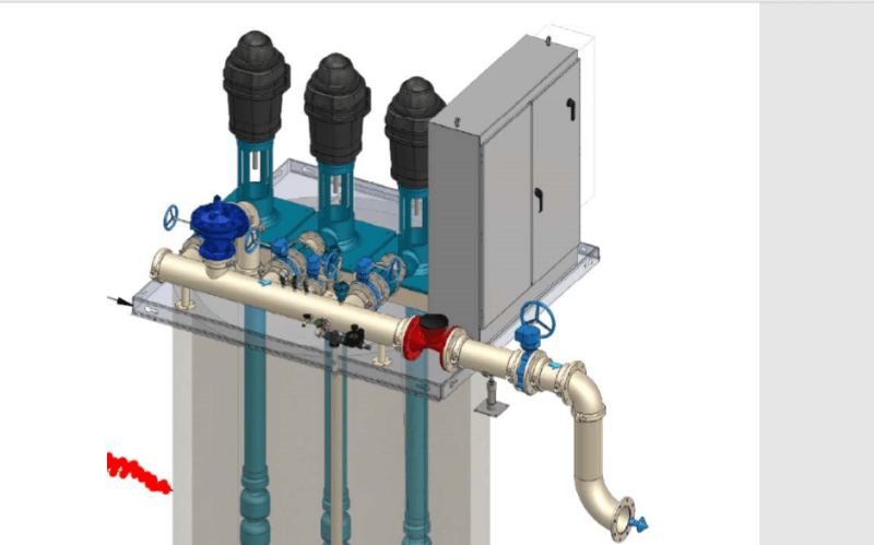

I am working on the design of 3 pumps siting on top of a circular slab of a wet well.
In PIP REIE 686, it states that "A dynamic analysis of an elevated frame foundation(table-top foundation) shall be required to demonstrate that the natural frequencies of the foundation do not coincide with and are separated from the operating speed range of the equipment by at least 20 percent. The foundation design for variable-speed equipment will require that the foundation be checked for resonant frequencies through the entire range of operating speeds."
Would anyone happen to know a technical document that has an example of performing a dynamic analysis for a table top foundation?
PIP REIE 686 states: A “table-top foundation” is an elevated three-dimensional reinforced concrete structure that consists of large beams or a thick slab connecting the tops of the supporting columns. The mechanical equipment is supported by the large beams or the slab located at the top of the structure.
Suggestions/comments are appreciated.
I have uploaded the plan, elevation, and isometric view of the Pump Skid that I need to provide a foundation for in relation to the Wet Well in the following link:
I have confirmed with the vendor that the skid shall be design to resist all the dynamic loads/forces caused by the pumps mounted on top of them.
My issue now is to provide a foundation design for the pump equipment skid. The issue is it seems that I will need to have a large hole inside my skid foundation.
What is the best way to tackle this type of skid foundation design? What is best practice?

Look at the sketch below. It seems the skid width "B" is the same as the "D"iameter of the wet well. Yes, you need some corner detail so the skid will be sat in comfortably. The wet well looks like to be fully covered by the pump system, if maintenance access is required, how the cover slab is to be uncovered/liftoff? These are the details I'm concerned with.
I think I see what you're saying now.
I actually cannot believe that I didn't realize it sooner, but since the actual outer diameter of the wet well is 10'-6" (126"), the skid as shown will have to be mounted to the top of the wet well.
Only other option I can think of is to request that the skid vendor increases the foot print of the skid to be much greater than 126".
Or, then the situation that I have is a "table-top" dynamic design condition.
[ I was mainly look at this picture provided by the vendor, instead of what is actually going to be built. I am glad I caught it now. ]
Has anyone ever come across this type of situation before regarding a pump skid foundation?

I cannot change the location of the pumps. They need to be above the wet well. This has been determined by the civil engineer.
The link below shows the current configuration of the pump skid on top of the wet well. The 108" x 99.25" box represent the pump skid & the 3 boxes inside the wet well circle represent the location of the 3 pump:
Would this situation be considered a "table top" situation regarding the pumps, based on PIP REIE 686?
Would it be acceptable to just design the top slab of the wet well for 3 times the weight of the pumps?

1) Your system will never be classified as a "table top" system, which is characterized as heavy dynamic equipment supported by a massive foundation that is free to swing in lateral directions.
2) If there is nil, or minimal, dynamic/vibration effects, you only need to design the slab for slab self weight, the operation weight of the pumps, and service load, if any. The slab should be thick enough to allow the placement of anchorages, if required.
3) Again, as addressed in 2 above, you can directly anchor the skid to the wet well, that has adequate thickness.
If concrete slab is provided, make sure it can be removed for maintenance access.

Their are 3 pumps resting on top of the Wet Well top slab.
Each pump weighs 1,583 lbs. Each pump has a power rating of 1800 RPM. Each pump has an operating speed of 40 HP.
The total pump weight is then 4,749 lbs for all 3 pumps. The total power rating for all 3 pumps 5400 RPM. The total operating speed for all 3 pumps is 120 HP.
I ended up increasing the circular slab diameter to 11'-0" with a thickness of 15 inches. My actual weight ratio is 3.71. This weight ratio also includes the subtraction of the opening of the pumps through the top slab.
PIP STC01015 Structural Design Criteria states that "Unless specified otherwise by the equipment manufacturer, for grade mounted centrifugal machinery 500 horsepower or less, in the absence of a detailed dynamic analysis, the foundation weight shall be designed to be at least three times the total machinery weight. Weight of a grouted equipment skid can be considered part of the foundation weight for this provision."
PIP STC01015 also states,"Support structures or foundations for centrifugal machinery greater than 500 horsepower shall be designed for the expected dynamic forces using dynamic analysis procedures."
Based on this criteria it would appear that the wet well top slab is acceptable. Especially since all 3 pumps added together is less than 500 HP.

I think I can agree on the way you handle the mass and power, but combining the speeds in comparison. Since the pumps look like rotary type, so you are in the right path to have the slab weight at least 3 times of the combined pump weight. But ultimately the thickness needs to be verified by the vendor furnished reactions, and dynamic characteristics of the pumps in operation.
retired13 said:
....but combining the speeds in comparison.
Could you please elaborate on the issue you have with the speed being combined?
The speed is still less than 500 HP with all of the pumps combined.
"rpm" (revolution per minute) is a measure of rotational speed, and "HP" (horse power) is a unit of measurement of power, or the rate at which work is done. When I say "I can agree on the way you handle the mass and power", it was based on the assumption that these pumps arranged and operate in series, not in parallel. I think you shall find and go over some examples on design of dynamic/vibratory machines, if you are interested in this topic.
