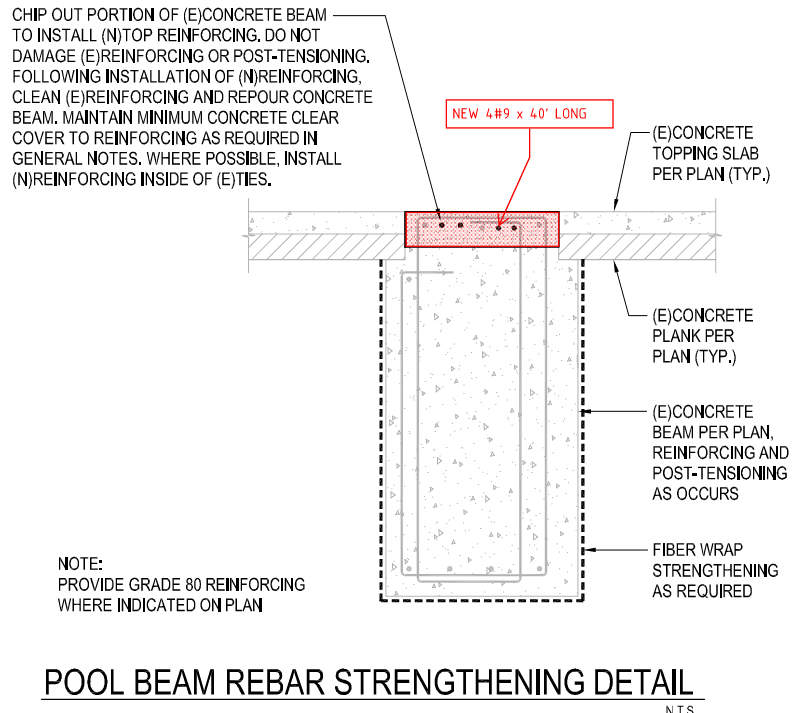

This came up a few years ago on a project I was working on.
Large multi-disciplne EOR detailed an increase to the negative moment capacity of existing PT beam to a pool deck, and they 'simply' wanted to install new 4 each x #9 rebar x 40' long. Bit of concrete chipping, bend out the stirrups, install the rebar, re-bend the stirrups, place concrete.
By not showing the real as-is sitiation their drawings did NOT detail the top slab rebar (#6 bars, perpendicular to beam), so I sent a RFI asking the EOR for 'means and method' of instalaltion of the new #9. Got a initial reply the from EOR that M&M was the responsibility of the GC. I replied with a 'means and method' that included cutting every #6 top slab bar to install the new #9's. The formal RFI reply came a few days later from the EOR was that their section detail was a drafting error. Yeah right!
We design/built an altenative negative moment beam strengthening that was buildable.

My professor always stressed that you need to be aware of how much space #9 bars take up compared to #4's. They are all the same size dot on the detail. I would tease the rod busters that even if they were having a difficult time, it worked on the drawings.

Engenuity and TigerGuy, yes it goes both ways. Sometimes engineers do specify overly simple design solutions that ignore real world complications, expecting that the folks in the field doing the dirty work will bail them out using know-how that the engineer doesn't possess. I totally agree that engineers need to be aware of constructability issues, and the best way to learn these issues is with hands-on field experience during construction.
In this case though, the OP was about repairing a deck. XR250 didn't say, but I am guessing the deck in question is a residential, wood deck, and I'm guessing it needs repairs because it was probably built by a construction cowboy and probably without a permit. A bit different scenario than chipping concrete, cutting rebar, and reinforcing a PT beam.
