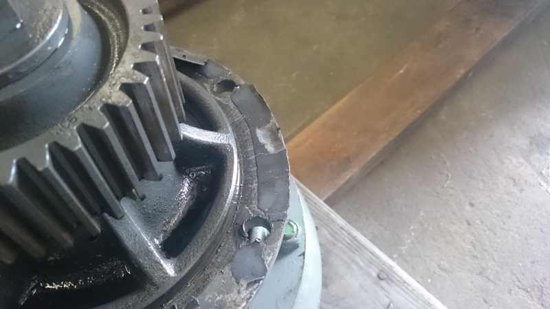

Here is an extruded gasket just or illustration. It's not even under pressure, ever.
