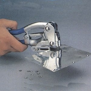

If the holes aren't in the middle of a very large sheet, I try to use a sheet metal hand punch:
The distortion you see in the photo is from using it on paper-thin aluminum. IME this tool won't distort your 0.04" sheet of Cres.

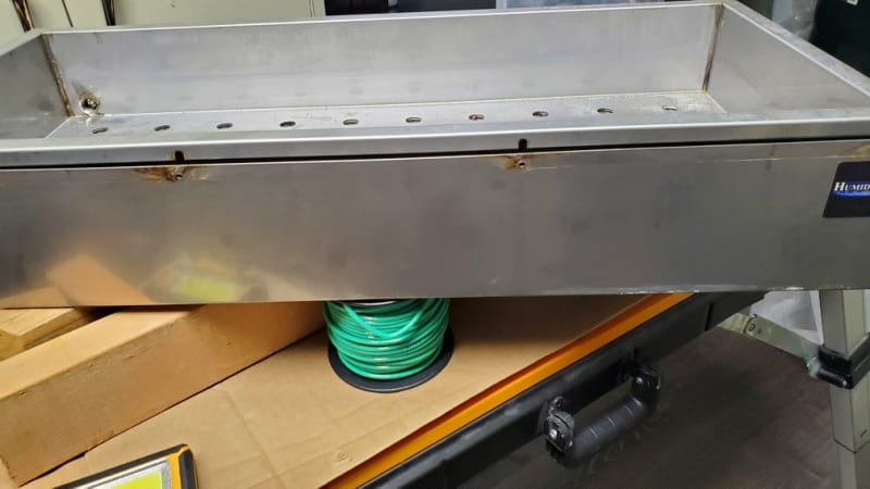

Here's a shot of the problem child:
The holes will run along the bottom edge about 1/2" from the bottom. Sooo no cool hand punches WindWright.

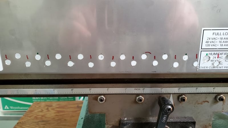

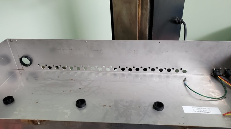

Well, out into the rainy dark I stalked with my cache of drills and the stainless pile seen above.

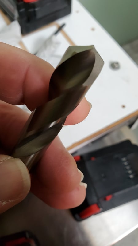

Opening one of the big 13mm Cobalts I love the jewelry like look and finish and the dangerous potential it implies.
I planned to use my little mill but quickly discovered this box on it's side used up all but about 3" of my Z travel leaving nothing for a collet mounted drill chuck or the drill bit.

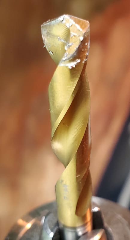

So I chucked up the 6mm TiN coated "sheetmetal drill" in my Milwaukee Brushless drill with a fully charged 5Ahr battery.
I was able to blast out 40 holes. It took a while since I used three clamps for my 3 inch wide aluminum backing plate I had to move numerous times. That picture is after the 40 holes. I pushed HARD and each hole took about 5 seconds.

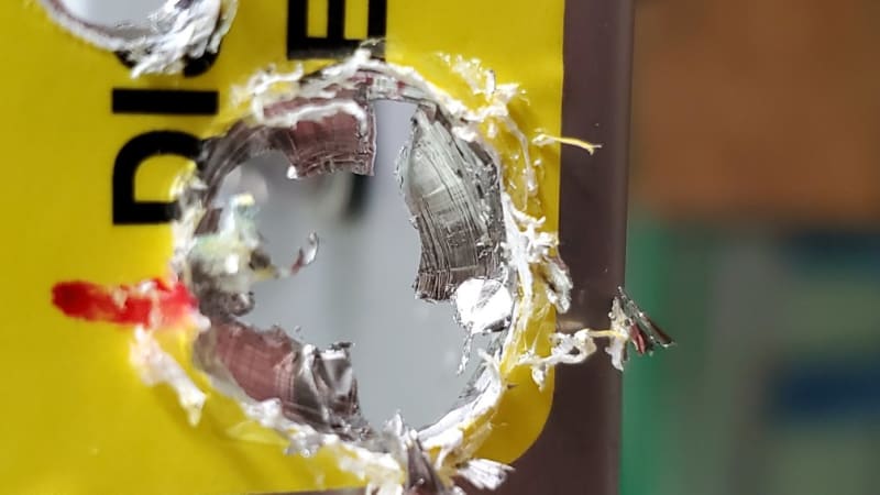

Then I chucked up the 13mm and tried the first hole. ARGH!!!!!
No dice! It left that nasty result.
I'll use my buddy's offered step-bit tomorrow and see if that's any better.

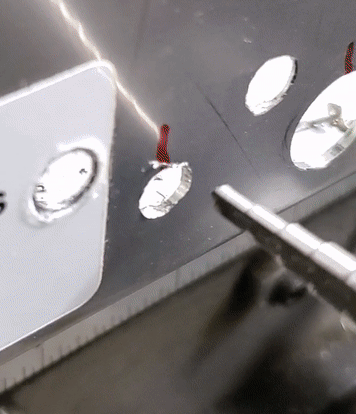

I still had some burrs on the 6mm holes so I used the 13mm to deburr them on both sides and it worked a charm on those. Took maybe 2 seconds a hole side. Used one bar of the battery.
Stay tuned for the saga of the 13!

Berky; The slot was a contemplation of having all the above holes laser'd out of some flat-stock that then was screwed onto this box instead of trying to drill the holes in the box manually. The slot presented an even worse problem so I gave drills and stepped drills a shot. And it worked. (Drilled 40 6mm holes with a Titainium Nitrided "sheet metal" drill then chased 20 of them with a stepped drill that maxed out at 1/2" which was apparently enough to fix 20 "13mm" fuseholders.)
