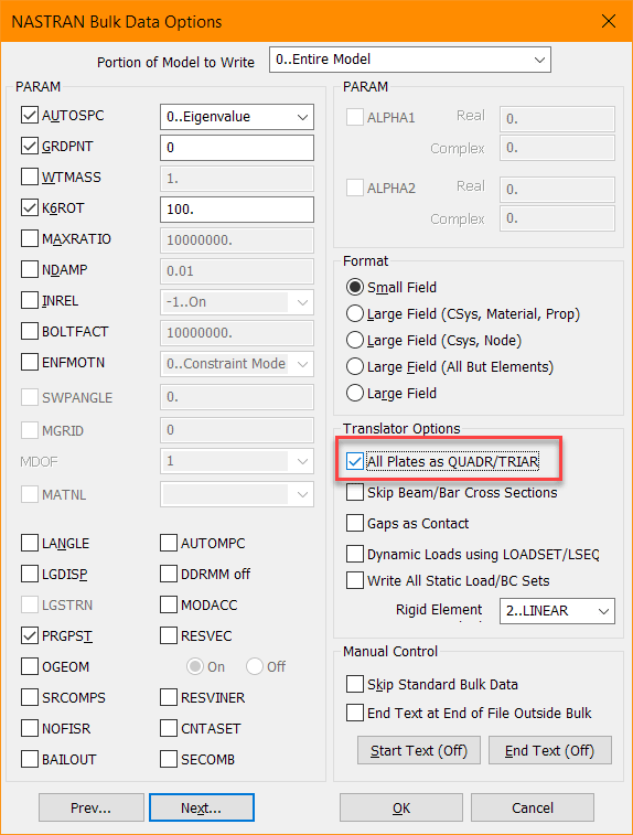

interesting … how do you specify CQUADR in lieu of CQUAD4 in FeMap ?
Hello!,
Is very easy, in the NASTRAN BULK DATA OPTIONS of your analysis make sure to activate ALL PLATES AS CQUADR/CTRIAR, then all plate elements in the model will have rotational stiffness in the direction normal to the plane of the ele­ment.

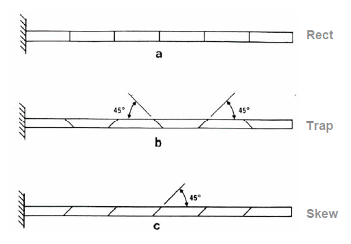

One place where the use of cquadr's benefits greatly over the standard cquad4 is modeling membrane behavior using coarse grid fem's. The classic McNeal-Harder beam test problem (as shown below) is taken as an example case:
The loading being studied here is an in-plane moment applied as a force couple at the free end. The results presented here are the tip deflections normalized to the theoretical value.
But if you run into applications where you have to transmit drilling loads into shells you still need to transform the moments to force couples by "spidering" out to adjacent grids using beams, rigid elements (rbe3, rbe2). IMHO!!
