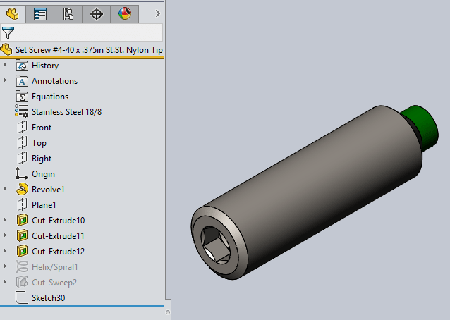

@APG63,
The slow down caused by the threads can be easily avoided by suppressing the Helix feature.
That's what I do as well CBL and then I change the face to a lime Green to represent the threads.
APG63 - Also, you will want to go into the Image quality of the Mcmaster-Carr parts and turn down the detail. Its set to high and will also slow your box down.
