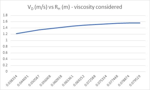

Below is a chart of deposition velocity (ft/s) related to hydraulic radius (ft) where the viscosity is considered. d85 is 0.5 mm, μL is 0.00167 Pa•s, CV is 52%
This chart shows a negative relation of VD and RH: the bigger the pipe/launder, the lower the deposition velocity, which looks ridiculous. So, I doubt the correctness of the equation (6-53) mentioned in Slurry Systems Handbook

Hi Robert,
Please find attached a file with screenshots of the "Deposit velocity of slurry flow in open channels" paper by Dominguez et al from 1996. There is a small mistake in the formula in Slurry Systems Handbook when the slurry viscosity is to be included. The superscript "3" is missing from the last part of the equation.

Hi Mech85,
The calculation is done with the corrected equation.
(by Dominguz et al. 1996)
(from Slurry System Handbook)
Where:
μm slurry absolute viscosity (Pa•s)
μL carrier absolute viscosity (Pa•s)
ρm slurry density (kg/m3)

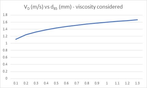

Below are charts of deposition velocity VD (m/s) related to hydraulic radius RH (m) or particle size d85 (mm) where the viscosity is considered. d85 is 0.554 mm, μL is 0.00167 Pa•s, CV is 9.64%
The relation between deposition velocity and particle size illustrated below where RH = 0.06536 m and CVf = 4%
The relation between deposition velocity and hydraulic radius illustrated below where Cvf = 4% and d85 = 0.554 mm
This chart shows the relation of VD and RH: the bigger the pipe/launder, the higher the deposition velocity, which looks regular. So, I think the equation above for deposition velocity of slurry in open channel is rational.

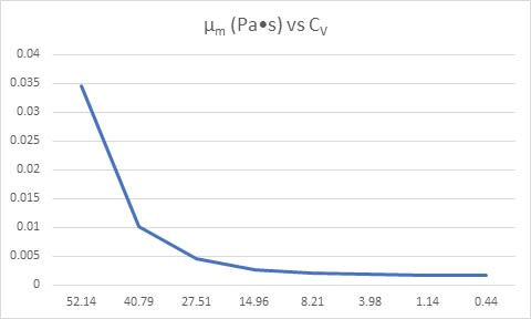

The equation for slurry dynamic viscosity calculation is also checked with solid concentration by volume where liquid dynamic viscosity μL = 0.00167 Pa•s
(from Slurry Systems Handbook)

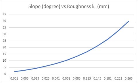

I have done a study of Darcy friction factor formula to find the relation between open channel slope and channel wall roughness or solids concentration.
(6-56) in Slurry System Handbook by Green et al. 1978
Where Reynolds number
(page 6.31 of Slurry Systems Handbook)
slurry density
Slope
(6-6) in Slurry System Handbook
The chart below shows the strong relation of slope and roughness where
CV = 52.14%
RH = 0.06536 m
V = 2.32 m/s
The slope changes 37.81° from 1.87° to 39.68° while effective linear roughness changes from 1x10-3 mm to 265x10-3 mm.
I found the slope for slurry gravity flow in open channel is only related to the wall roughness, from the calculation of Darcy friction factor vs solid concentration by volume.
