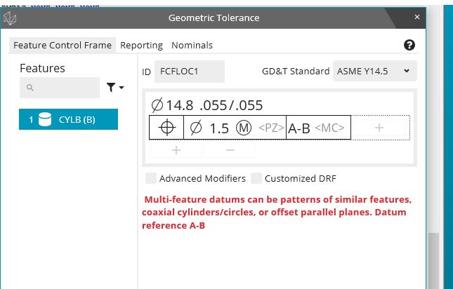

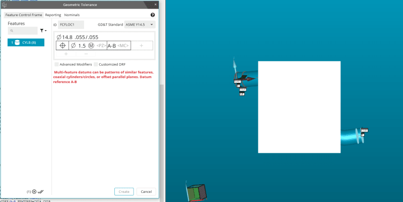

Question to the experts:
Is this legitimate control?
If no, why?
If yes, how datum / feature / simulator looks like?

Can I get unambiguous Yes-or-No answer to simple straightforward question:
I would say, yes it is.
The same is true for B-C, B(M)-C, B-C(M)--legit controls. Not sure if functional, but you did not ask for that.
CH,
I would say that your A|B-C control is legitimate as far as Y14.5 is concerned. The B-C reference is qualitatively similar to the C-D reference in Figure 7-17 from Y14.5-2018 (or Figure 4-25 from Y14.5-2009). Both define a multiple datum feature / common datum feature using two cylinder features of unequal size, and then reference that multiple datum feature at RMB in the tolerances applied to those cylinders. There are examples of this in the runout section as well.
I'm not saying that this is a good idea, and I don't recommend it. I've always thought that these quasi self-referencing callouts were conceptually questionable, and I don't see a connection to any functional requirement. There is also the practical difficulty of how to measure the feature's axis or surface after lining up on it as a datum feature. As you said earlier, it is only necessary to control B and C relative to each other via simultaneous requirements - the B-C self-reference isn't strictly necessary.
Regarding the datum feature simulators, there are subtle practical issues here. The caption in Fig. 7-17 states that the "true geometric counterpart is the smallest pair of coaxial circumscribed cylinders". When applied to the B-C feature in your example, Y14.5's logic would mean that the datum feature simulator would be the largest pair of basically located inscribed cylinders. If we look to the text to see how to find the largest pair, here is what it states in 7.12.4 Pattern of Features of Size RMB:
"When RMB is applicable in a FCF to common datum features of size used to establish a single datum, the TGC of each feature shall be fixed in location relative to one another. The TGC's shall expand or contract simultaneously from their worst-case material boundary to their LMB until the TGC's make maximum possible contact with the extremities of the datum feature(s). When irregularities on the feature(s) may allow the part to be unstable, a single solution shall be defined to constrain the part."
There has been a lot of discussion and debate in the committees over the years regarding the exact meaning of "maximum possible contact" in this context. Specifically, the point of contention was whether or not the TGC's had to always expand/contract together, or if one TGC could keep expanding/contracting after the other TGC stopped). The last sentence in 7.12.4 is new in Y14.5-2018 and is an attempt to address this. It refers to the new "single solution" default for unstable/rocking datum features, that replaces the former default of a candidate datum set. This is another can of worms in itself, that would be better discussed in a separate thread.

CH,
Referencing a multiple datum feature B(M) - C(M) is generally a legitimate practice, as long as long as the virtual condition boundaries are well defined. How this would play out in the context of the quasi self-referencing FCF in your example is actually an interesting question.
The TGC's (simulators) for datum features B and C would be pins, fixed at the VC sizes of B and C. These would be the same size pins as would be needed for gaging the position tolerance itself. So the A|B(M)-C(M) references would apply the same control to the features as A| only in this case. I suppose this means that specifying A|B(M)-C(M) is legitimate, but redundant.

The bent tube examples highlight certain issues, some of which expose limitations in Y14.5's current theory.
The way I think of it is that we can always define the TGC's / simulators and identify the degree of freedom constraint from those. Y14.5 describes the requirements of TGC's near the beginning of the DRF section (7.5.2 in Y14.5-2018), and I would say that these requirements are generally correct and not controversial. The TGC's have perfect form, basic orientation and location relative to the other TGC's, are fixed in size for MMB or LMB and adjustable in size for RMB. This tells us what we need to know to define the gage elements needed to hold the part. From those gage elements, we can identify which degrees of freedom would be constrained and which would be left open. This type of analysis works well, even for the bent tube examples with A-B datum features that are skewed relative to each other (or two offset parallel planes). The TGC's (and gage elements) are still basically oriented and located relative to each other. The A-B TGC's in the OP example would constrain all 6 degrees of freedom, but not overconstrain.
If we try to go further and identify datums and a DRF, this is where things can go off the rails. Y14.5's datum theory is based on simple configurations of datum features, and does not generally perform well when applied to less simple configurations. This is why we struggle to define a single datum axis from the two skewed cylinders - there is no unique way to do this. We have two TGC's that are skewed relative to each other, and there is not a unique or obvious way to define a three-plane coordinate system in them. If we look at the Primary Datum Features table near the beginning of Y14.5's DRF section, we see that the 2 skewed cylinders form a Complex datum feature and the datum is an Axis, Point, and Center Plane. To me, this description is only useful for special-case features like the oblong cone shown in the table.
As you mentioned, another issue that the bent tube examples introduce is part flexibility. For many parts of this type, there is enough flex to bend the part into full contact with multiple TGC's that would otherwise overconstrain a fully rigid part. It appears that this type of consideration may have been used in the SAE excerpt that was posted.
