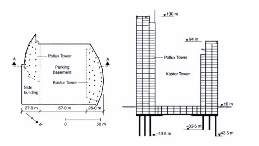

The foundation could be partially supported by soil and piles together. In this case, modelling the raft with FEM and the piles with hard springs and the soil with soft springs is the practice in our region..
Just for sharing the knowledge, i added the section of ( forum building complex Frankfurt ) Notice that, the raft is designed as single structure..
