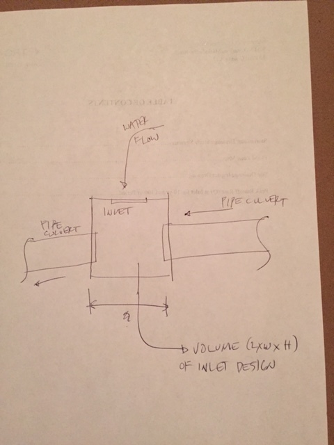

if I calculate the Q of a given area draining to an area inlet like the pic.
Inlet is standard install by county. Does this inlet have Q capacity?
@cvg,
can you link me to inlet volume capacity (LxWxH) design.
Not the inlet grate opening which i have already calculated using hydraflow.
I can also calculate the pipe culvert diameter.
Unfortunately, civil 3d hydraflow does not calculate the inlet volume/area.
I have not looked into civil 3d storm sewer design.
Do I even need to calculate it. I think the volume/area of inlet is bigger than the volume/area of pipe culvert outfall?
I've never calculated the inlet volume. It's the smallest possible to fit the pipes (usually) or the grates for inflow (rarely).
Your structure has to be big enough to fit the holes they cut for the pipes. Attenuation volume in simple junction boxes is almost always neglected.

3' wide x 3' long x 4' high
a typical storm drain inlet structure has a volume of maybe 30 or 40 cubic feet (up to the top of the pipe) and at 2 cfs, that would be completely full in say 15 seconds at peak flow. Once it is full, there is no attenuation of flow. Some software such as stormnet and SWMM do allow you to enter volume of inlets and manholes. But frankly, it is a waste of time for analysis of peak storm flow.
If you really want to get crazy, than calculate the storage capacity of your pipes as well and include that in your routing also.

Yes. That inlet has Q discharge.
How much Q discharge do you need? How are you figuring it?
What is the maximum depth of flooding that is acceptable?
Take that depth, and use it to drive the Q through the opening with the orifice equation. Then halve it (blockage). There's how much Q that inlet can take before you start to flood.
For instance, assuming those openings are (WAG) 1"x6" (times 40 openings) with 1' of head... drumroll... the Q discharge that inlet has is 8 cfs. Woops! It's clogged, use 4 cfs.
The inlet capacity increases with the Head above it (depth of ponding water), assuming it is located in a sump.
I normally use Hydrualic Toolbox.
Now, when you have a Q and want to see if your Inlet can handle it, just enter the maximum allowable ponding depth (Head) at the inlet and determine the Q(inlet). If the Q(inlet) is greater than your Q from drainage area, you are ok. If not, resize the inlet opening. Just like Spartan5 suggested, I would follow that method.
Since there is a trash rack at the inlet, the inlet should be designed to accomodate discharge considering some percentage of choking conditions. In hydropower we consider 50% of the net area choking condition.
