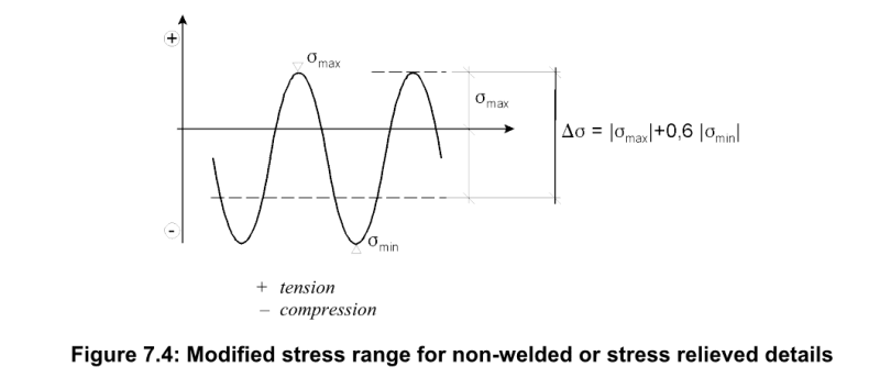

Out of interest I note Eurocode has rules for dealing with fatigue and compression loading for non-welded and stress relieved details. If I'm interpreting it correctly, it allows you to effectively reduces the part of the stress range in compression to presumably allow for the improved fatigue life when all or part of the total stress range is in compression.
I'm not familiar with the Eurocode, so I won't comment on that, beyond pointing out that the figure posted shows a stress range that includes tension (stress reversal), not one strictly in compression, so I don't find that in itself to be convincing. What I quoted was from the 8th Edition of the AASHTO LRFD code published last year. AASHTO usually keeps up to date with and incorporates recent research findings, so either what you were reading is very recent, or the eggheads who propose changes to the code provisions didn't find it relevant or didn't find it convincing.
I'm not saying it isn't possible for some cracking to occur due to strain hardening in compression followed by stress relief in the component. I'm just having a difficult time envisioning how the crack would continue to propagate to failure. I also don't see how any portion of a component limited to the yield stress for design reaches strain hardening for cyclic loading.
Just to clarify the point you are reading into the Eurocode provision, the reduction for compressive stresses applies specifically if part or all of the stress range is compressive, its not reserved to stress reversal cases that also go into tension.

A closer look at the recent DNV-RP-C203 -publication shows that fully compressed stress range with no residual stresses does not lead to fatigue:
If the thread of the bolt is rolled, there exists residual stresses and the DNV reduction factor is not zero. If the compression load is big enough, there exists local yielding in the thread, which lead to residual (tensile?) stresses and the DNV reduction factor is not zero. Thus, the compressive load range should be 60% effective.
So, according to the Eurocode and DNV, a fully compressed bolt has an effective stress range which is only 60% of a fully tensile case. I didn't find any fatigue test data of this kind of case by Googling, so I think, I will settle with this result.
