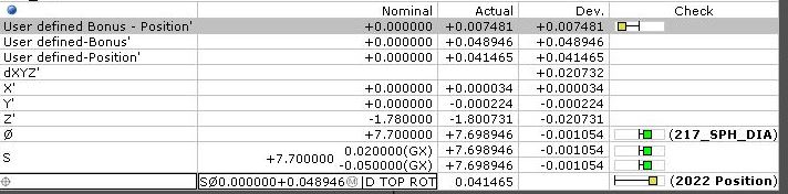

Is the below valid without locking down rotation so you have a plane to measure distance from x and/or y distance from?
The datum cylinder A defines X & Y in location and datum plane B defines the true position distance of the sphere below said plane. So in theory you can garnish a radial deviation from this true position in space, but what you can't do is define said deviation from a X and Y plane. So you have your overall deviation, but it can't be quantified with the typical X & Y deviation. Therefore, I'm wondering if this particular callout is valid b/c the rotation isn't locked down via a tertiary datum ref frame.
Thanks.
Oh, I get it - since I was talking about TOLERANCE and the TOLERANCE is a SPHERICAL DIAMETER then it's compared to the SPHERICAL DIAMETER TOLERANCE, not the diameter of the spherical feature.

"It's a sphere - it hasn't got a way to measure rotation.
It's acceptance is that dX^2 + dY^2 + dZ^2 <= (S Dia./2)^2 at MMC."
The equation is for the sphere's center point, not for the sphere.

"Which equation is for a sphere's center point?"
In the context of the position tolerance, describes the spherical volume in which the center point of the sphere may be located.
It doesn't "locate" the center of the sphere. That location is from the measurement by, in this case, the CMM. The equation doesn't locate the center - the center is an input value.
The function produces a scalar value, not a vector, so it cannot locate anything.
Wrong reasoning.
dX dY dZ are coordinates in a Cartesian axis system. Obviously, they represent the location of the center point relative to an origin of measurement. If the <= condition is answered, the location is within the required limit.
Wrong reasoning - it doesn't locate the sphere's center, it determines if the center is within the boundary for acceptance. It converts a vector into a scalar to compare with a scalar limit.
It's peculiar to tell a person who created an equation what it's for.
You didn't invent the mathematical expression for a sphere. The expression dX^2 + dY^2 + dZ^2 gives r^2, where r is a radius which is simply a distance from some (X,Y,Z) point to any point of a considered spherical element. In this case the (X,Y Z) point is the true position, and the radius "r" is the deviation of the actual sphere center from that true position - and guess what it describes - the location error.
The other expression of the equation you "invented" is just the maximum allowed dislocation distance from true position (per the tolerance value at MMC), squared.

If 'S Dia.' in the equation dX^2 + dY^2 + dZ^2 <= (S Dia./2)^2 is the tolerance zone diameter at MMC, then dX, dY, and dZ should be the deviations of the center point from true position. If they are not, what are they?
As said before - this is not an equation that tells where the center is. The user has to already know where the center of the as-manufactured feature is.
