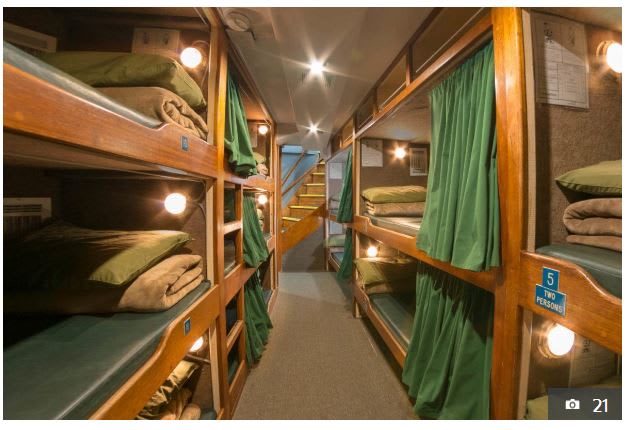

This view shows how bad it must have been.

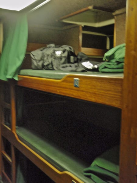

I've been on a similar eighty foot fishing boat like this on over-nighters to Mexico. I liked the berths below for their "coziness" on the rocking boat. The sleep can be deep, with no pun intended. On our boat, there were two stair exits, and like this boat, they were side by side. The crew sleeps topside out of courtesy to the guests, who get the 'good' sleeping quarters below (ever spent the night out to sea in the rain?). Having worked with buildings, I noticed the bad egress compared to buildings.

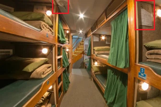

Nice find, the picture of the escape hatch. So well marked and un-obscured.
Also see. Guess a second stairway was impracticable, since it would reduce bunk space.
OHG that looks like such a deathtrap... I really can't believe it. Am I seeing that you have to climb the stairs AND THEN traverse the entire second floor to an exit?
