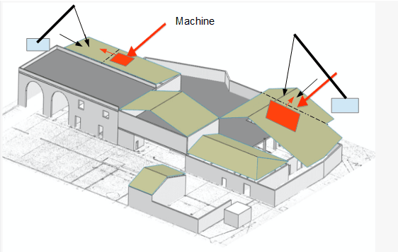

Greetings,
Would anyone have a clue on how to dismantle this without taking too much risk or damaging the machines beneath it?

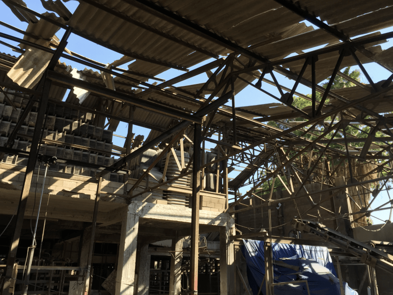

You can't put workers below the roof as is, the fibrocement tiles can fall anywhere anytime, workers would be at serious risk
also the roofing has collapsed so much that touching the machine
maybe with some clever sequence, so that worker stay protected, but wouldn't making a protective structure that big be quite expensive ?

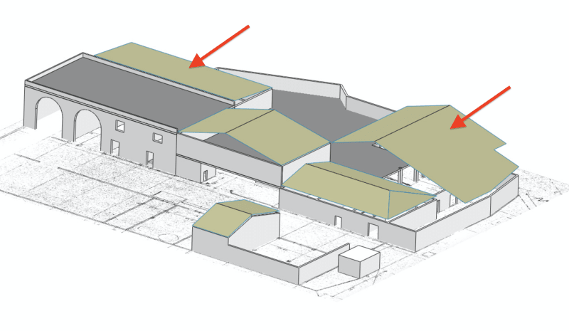

overview of the site, arrows designate the 2 parts that have been affected.

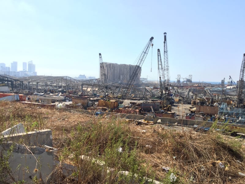

it's in beirut lebanon, near the port, after the mega blast few days ago
The arrow on the right corresponds is another damaged part, same issues, more complicated truss though
Agent666 - "craning out complete sections of the damaged structure" - yes, that was what i had in mind. I wonder about how big the crane needs to be though. Access is from the road between the two structures (the small hangar and the main bldg), can't do it in another way.
Same idea here, but may require torch the roof to several manageable portions. Read the structural prints to determine safe location for cut. Then use crane and man-basket to cut from top. You might need two cranes operate together to provide stable platform for work.

I'd be hesitant to crane it out. One, you'll probably be on a waiting list. Two, how do you define "in tact" sections? I don't see any in the pictures. A small crane to remove the trusses when the time comes, and maybe with a basket to lower a worker down to remove the roofing if you can get one, but from the pictures I don't know about removing large sections.
phamENG - not sure about the netting, horizontal loads could be quite big if a truss falls (they're seriously damaged, with strut buckling and LTB). The fixing of the net would mainly be done on masonry, would need extra structural element to route the loads to structural members. There's a lot of damage from the blast, even on concrete structural elements. What i'm looking for is to take the machines out before repairing (maybe partially demolishing) the construction.

retired13 - can't put 2 cranes, i only have crane access from one side, and there's a significant distance to the truss members, huge crane i guess, $$$

MIStructE_IRE - almost a mile away.
Pic from hangars nearby ground zero:
retired13 - could be, i'd need to find a crane that can lift 20 tons tough, maybe 10 tons if i manage to dismantle the machine enough. Pretty big one i guess, that calculator suggests a 200 tons crane ...
Ok, i guess it's going to be a crash deck near the roof, by using scaffolding. Got to figure out a way of assembling this without putting people at risk.
