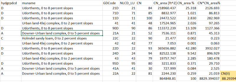

Hey again, thanks for taking the time to help me out. I'm attaching the CN calculations and data broken down by area. As you can see, the values aren't uniform across the basin. I did detailed calculations and area percentages, but since, as I mentioned, it's primarily an urbanized area, I'm getting high CN values.
I understand the more detailed approach you're suggesting, but there's only one stream draining into the lagoon, though there might be other minor drainage paths. While I get that the approach could yield more accurate results, I don't think it would significantly affect the peak flows. I've previously used a single basin approach, even for larger areas, and it worked well.
However, I believe I found the issue: it looks like I miscalculated the time of concentration (Tc). Using the SCS Lag Time Equation ( and converting lag time to Tc, I get 7.7 hours, which gives me a peak flow around 150 cfs—close to the results from StreamStats and my manual calculations. But a Tc of 7.7 hours seems high. Using the Kirpich formula, I get a Tc of 20 minutes, which is also what SSA calculates. I understand that Kirpich is basic formula and can't be used in every situation, but still this is a huge difference.
