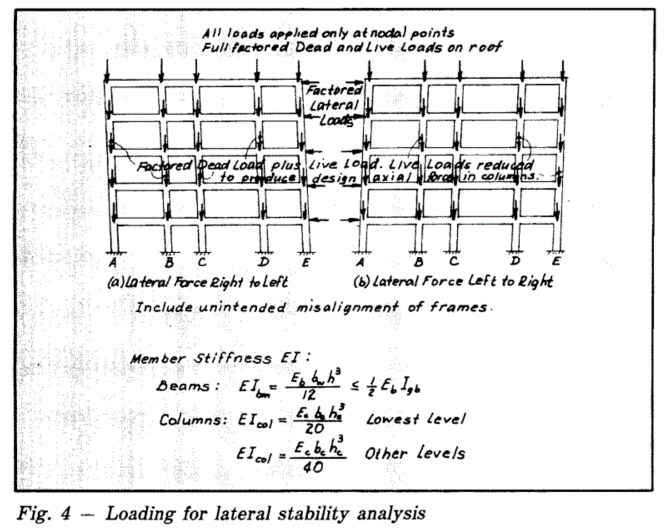

Not official documents, but Richard Furlong's papers about 'rational analysis' of concrete frames probably provide what you need. I'd divide his stiffnesses by (1+Beta,d) to account for creep. And he does recommend a final check of slender sway columns using the procedure for braced columns.

One of the Furlong papers I referred to is from 1981. When I found out about AISC's DAM this year (pretty filthy I didn't know sooner...), I immediately thought it's Furlong's method but for steel.
I like this from the 1981 paper:
Richard Furlong said:
The ACI Building Code, Clause 10.11.6, regarding moment magnification factors for columns in unbraced frames may have yet to be applied completely and correctly in the design of an entire concrete structure.

I'm not sure you'd (KootK) find much new material in the Furlong papers as it seems you're across the basis and practical requirements. The two I have are:
"Rational Analysis of Multistory Concrete Structures" (Concrete International, June 1981); and
"Elastic Rational Analysis and Tests of Unbraced Concrete Frames (in the book/proceedings 'Progress in Structural Engineering, 1991)
The 1981 paper shows its age by describing how to iterate manually so that a first-order-only analysis program can be used for p-DELTA effects (manually increase the nominal lateral loads after each analysis). Its member stiffness recommendations are superseded by ACI318. The remaining bit of interest is how he handles the differing area reduction of live load for sway effects (large tributary areas based on several storeys) and gravity pattern loading (small tributary area based on individual beams). See Figure 4 below - the gravity loads for sway analysis (maximum area reduction) are applied at nodes so this analysis only gives moments and shears for sway effects. You then add the worst-case effects for loading on beam spans (pattern loads with small area reduction).
The 1991 paper has updated stiffness recommendations (also superseded now) but also a proposed addtional reduction factor for frames with few columns. For two columns, the reduction factor is 0.66 so you analyse a lower-bound frame stiffness (dodgy concrete). For >10 columns, the factor is 0.9 (just a notional reduction of average stiffness) as that many columns should even our the frame stiffness to the value for 'average' concrete.
