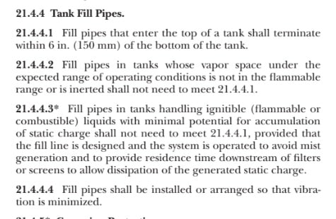

A paragraph in NFPA 30, if applicable:

You should describe in details jurisdiction and liquid stored. What "dip" stands for - filling or gauging?
HSG 176 Storage of flammable liquids in tanks said:
Tank connections and fittings
118 Storage tank filling and emptying connections, and openings for dipping and venting, should be located at least 4 m from any source of ignition, building opening, trench or depression. Any drain in the vicinity should be either fitted with an interceptor or routed to an appropriate waste collection/treatment facility.
122 The end of the tank filling line should extend below the lowest normal operating level of the liquid to minimise the generation of static electricity from splash filling. To prevent siphoning, the line should be self draining. Where separate lines are used for filling and emptying, a liquid seal can be maintained by ending the discharge line at least 150 mm above the bottom of the filling line. To minimise the risk of tank leakage, it is preferable for lines to enter the tank at the top. This may not always be reasonably practicable, particularly for large vertical tanks, which are normally filled through a low-level nozzle.
123 All dip rods and tubes should be earthed and, where appropriate, an earthing lead for connection to a road tanker should be fitted. See PD IEC/TS 60079-32-1.
