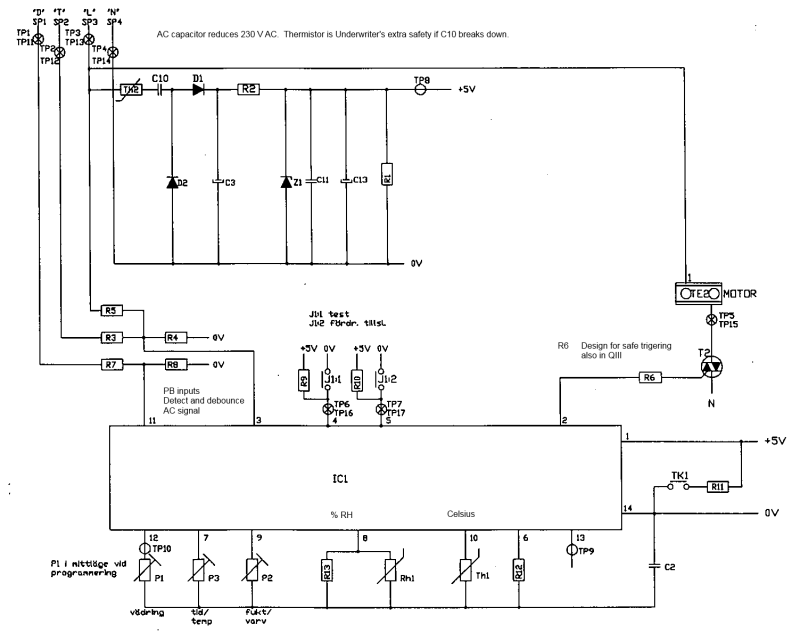

There are quite a few more. If this is going to be a commercial product, it will never survive in the market. Too expensive. Too many components. An example of a succesful commercial design is shown below. One of the simplest PICs ever, no A/D. No transformer and still does timing temperature control and humidity control.
We designed that sixteen years ago and the product has now been replaced with a smarter one. So esign is free. It works off a 230 V 50 Hz grid and we had a few problems during beta testing. Adding a ground plane solved those problems.
