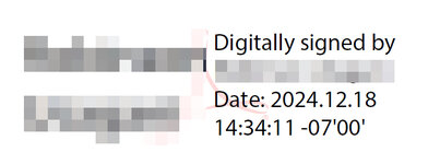

When you use digital signature from Adobe or Bluebeam, what do you typically do? Do you put your PE stamp blank without your signature or date and put this certificate next to it? Do you still add your signature on top of the stamp and add this next to it? Do you still add signature and date and put this next to it? What say you?digital sign.jpg

I went with identrust after reading some threads on here. They've got a few different levels of verification/cost but if you tell them you're just looking for the Florida PE licensure verification, someone pointed me to exactly what i needed.
My current certificate will expire in few months and they are raising their fees. For cost comparison, before I renew, would you tell me which one they pointed you to? Their website and selections do not have FL board of engineers.
I've got a 'Identrust Global Common Basic Assurance' certificate and it was $81 last year. Haven't gotten around to renewing so I am not sure if they have raised the cost
