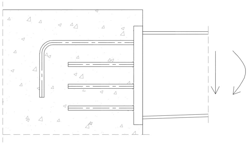

I have been requested to check the anchor bolt detail in which there are different types of anchor bolts in 1 bolt group embedded into concrete.
Could you please enlighten me how to check this, based on ACI 318.
Thank you.
My first thought is put all the tension from the bending couple in the top bar and the rest for shear.
Agree with the above.
Check out SCI P416 it has a methodology for checking this scenario. Convert to ACI provisions as appropriate as its based on Eurocode methodologies, which allows development around the top hook bend which ACI318 does not.
