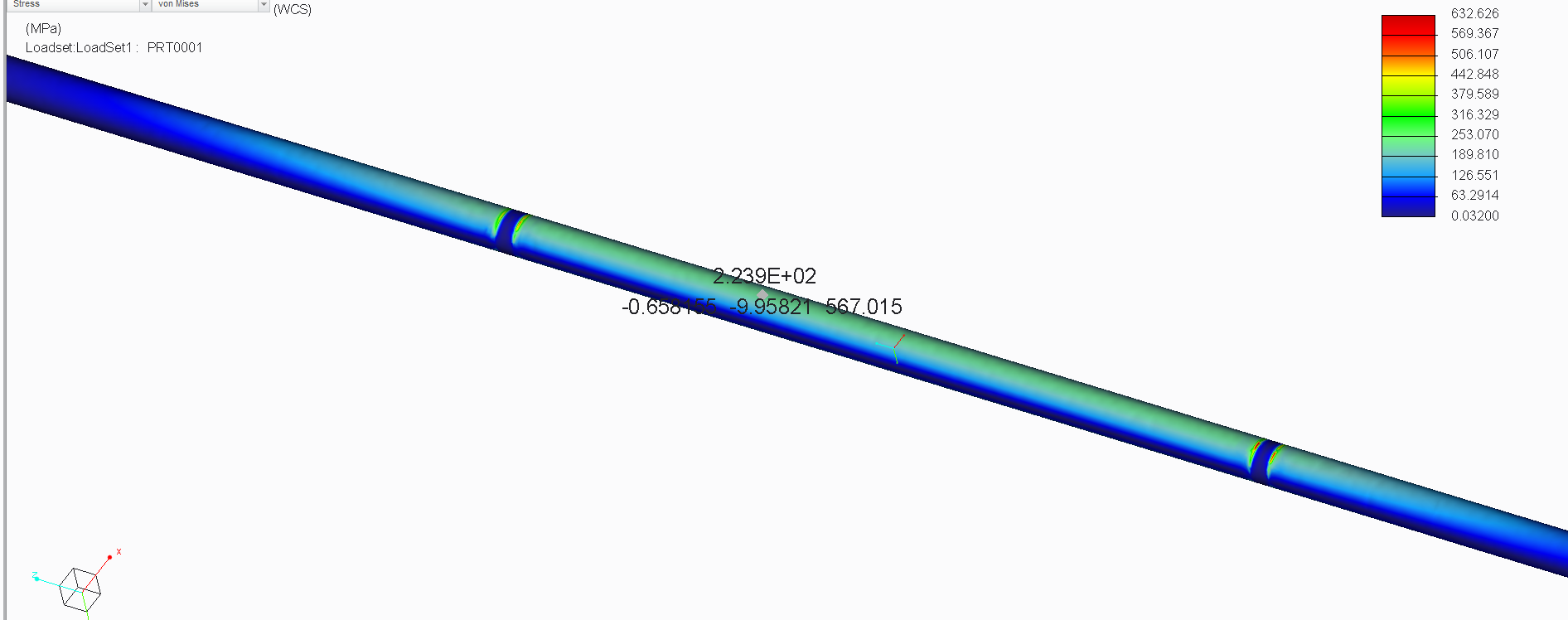

Meanwhile, I've done a FEM analysis of that system.
This is the result of the static analysis:
The stress is 224 MPa, the same calculated by hand.

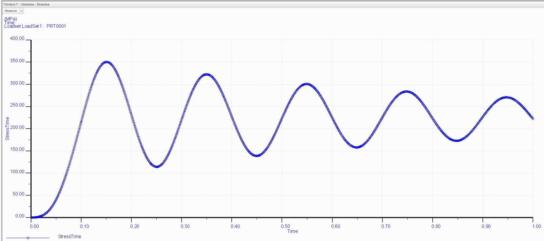

After that, I done a dynamic analysis. In that analysis, I simply placed the load at time 0 (what's happen in reality).
This is the stress over time graph:
As you can see, the maximum stress reached is 350 MPa, 1.6*F. I think that it is less than 2*F due to the damping factor: the potential energy converts into elastic energy and heat due to damping, so the real force is less than calculated.

The dynamic effect in your analysis is so called "impact", which occurs when both time of contact (duration), and elastic deformation (similar to change in length of spring) at contact approach zero. As pointed out before, impact is dynamic in nature, but simplified to a factor that is used in a static manner for ease of calculation. However, your simple acts on placing and moving object from the beam, in general, will not produce significant dynamic effect to reach the state of 2*F. But you are correct on effects of damping, which can be came from the flexibility of the beam, and rigidity of the supports. This is an interesting topic after all.
OP is not correct on the effects of damping - it should hardly have any effect on the first sine wave, only reducing the subsequent oscillations.

I think OP meant the object was placed on a softer medium (in practice) as opposed to a stiff medium (in calculation). So the magnitudes of the first sine wave are different, which is caused by the differences in damping property of the materials (some materials capable of absorbing more energy than the others). Otherwise, I agree with canwesteng.
I'm sorry but you're wrong.
Suppose that I'm holding the weight over the beam, the weight touch the beam without load it. In that time, there is no load over the beam: the system have only potential energy.
Then, I release the weight. Part of the potential energy will be converted into elastic energy, the remaining part will be converted into heat (because of dissipation).
It's not simple to calculate by hand, because that part of energy depend on the velocity.
If part of energy will be converted on heat, the deflection of the beam will be less than the deflection calculated without dissipation.
Less deflection = less maximum stress.
That's why in FEM the maximum stress is 350 MPa, and not 450 MPa as calculated by hand.

The issue is the "release;" is it instantaneous or not? If not, then your premise is incorrect. Any other input results in the energy spread out over time; if the spread more than 0.1 seconds, then the overshoot is substantially reduced.

I hope you didn't design car suspensions after all that study then. If you apply a force, F, to a spring, K (or a car suspension), you could have exactly critical damping, and you won't affect the initial displacement at all. Only the rebound effect, or free vibration, will be effected (in this case, this is different for vibrating loads of course, where damping reduces vibration amplitude, but note, that the amplitude of vibrations is always greater than F*k, unless the natural frequency of the spring is smaller than the forcing frequency).
