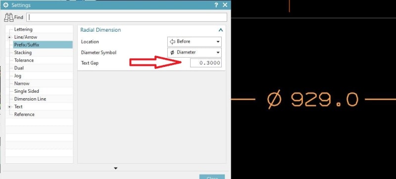

Greetings:
I have version NX 1926 Series. When placing a dimension for a hold, the diameter symbol is far from the number it represents. I'm wondering if there is a setting that can be changed to modify this gap?

It should be in your dimension settings
