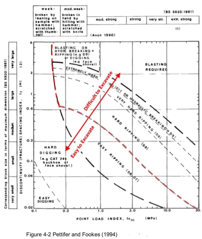

The Pettifer and Fookes 1994 method for assessing ripability is a good place to start. (Note the red line was added by me for a project.)
You will need to know you Is50 point load index and fracture spacing. Review your logs, fracture spacing should be shown. If not you will have to get the core boxes out and measure the distance between natural factors.

EireChch: Thanks for that chart. I don't have the Is50 but when we get into the project I'll get it. I don't intend on giving any rippability recommendations. That'll be up to the contractor.
