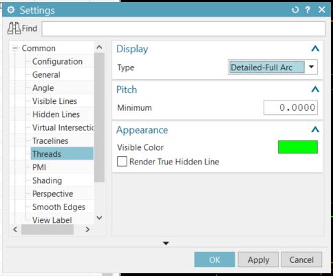

You can model your threads as symbolic, but show them as detailed on your drawing.

Look into the view setting of the drawing view,
Go into the threads setting,
Pick one of the detailed settings.
Even if you modeled it as a symbolic thread, it will show as detailed.
