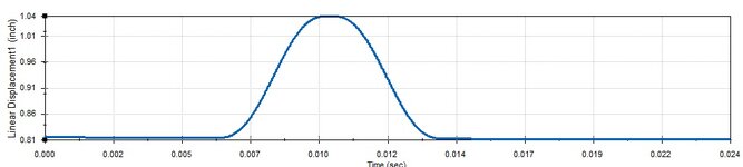

Hey folks,
Would like an idiot check.
I'm working on designing the camshaft for a small 4 stroke generator engine that will run at 5000 rpm. I've spent about 3 weeks total on cam design thus far and am having an absolute panic attack. lol
the cam has a base circle of Ø1.125 and a roller follower Ø.5
I started with cycloid, then modified trap, 3-4-5, then higher order... started messing with Cubic Bézier splines... and more less ended back up with a 3-4-5.
Anyway... I've been trying to keep things under 100g of acceleration and finally made it.
Ended up with a 3-4-5 that has a 100deg rise, and 100 deg fall no dwell. The actual equation says I should be getting about 79g but the simulation came back with a peak of 96.7g. I think that has everything to do with roller contact angle/pressure angle...
That said I was like oh... I'll just plot the roller center then cut out as it rotates to get the lifter to do what I want... omg. that's not possible... at least my simple brain can deal with it.
Anywhoo... I'm already at 200 degrees seat to seat on the cam. It's boxer engine, so no offsetting the cam bore I think this is it.
Is there anything else I can do?

200 degrees seat-to-seat duration sounds shy. Intake valve opening will probably be 10 or 15 degrees BTDC and intake valve closing will probably be at least 30 degrees ABDC and probably more, unless there's something going on that the rest of us don't know about. Lobe center at 100 - 105 degrees ATDC is in the plausible range. That would give 110 - 120 degrees to open and the same to close (if you use a symmetrical lobe) which would help cut down your acceleration. Obviously the right way to pin the cam timing down would be with a proper simulation.

BrianPetersen: Really... I was getting scared 200 was too much. I've not done something designed to live at this speed before but I guess. 120 degrees ought to drop it down A LOT more. (yes symmetrical lobe). I've got a pretty good dynamics simulation going right now and feel pretty good about things... but certainly not fluids... just a bunch of hand calcs for combustion speed and so on.
love child of metric stock parts, and inch design... lol. I had read about that .050" thing a long time ago thanks for reminding me that certainly makes me feel better about the 120 degree idea. I'll math it out tomorrow and run the simulation. probably gets me down into the 60-70 g calculated... probably high 70's in the dynamics sim.
Yeah going with solid lifters.... ugh that sounds gross. The 3-4-5 is VERY shallow on it's approach... I think it will be fine? :/
