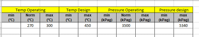

In what circumstances design temperature of a piping system can be changed?
-In a operating plant ,the operating temperature of a particular pipe system (where alteration/Modification required) is max 300 deg C,above which there will be alarm/Trip.But the piping is designed to a higher temperature of 450 deg C.Can the design temperature changed to 300 deg c or less than 450 deg C for piping modification/alteration etc.This is for pipe stress analysis compliance.

Design pr 54 bar
Operating pr 35 bar

@ 450 °C operating pressure= ???
@ 300°C operating pressure= ???
Please be clear with the information you send us.
Regards
Operating pressure is same for both temp
