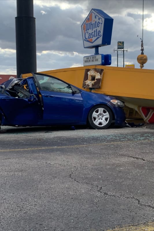

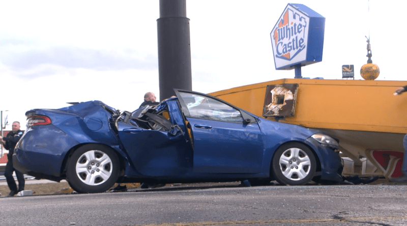

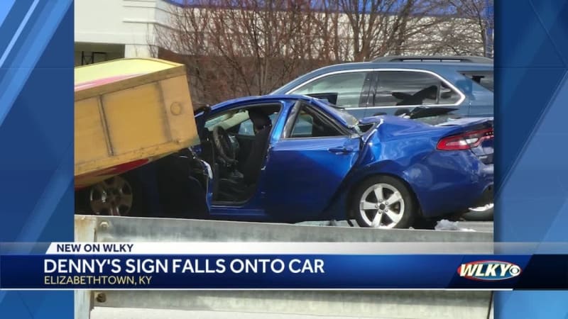

The sign fell from the top of the mast. The mast remains standing.

It would not havce occurred to me that the sign would weight 2,600 pounds, I can't wait to see the connection details between the sign and the post. Probably the least expensive design, I wonder if it was PE sealed.
Of course, Denny's now says "safety is top priority". Such lame posturing is infuriating, always after the fact. Was safety a top priority when the design was approved or maintained (if ever)? Will they take the time and money to examine all their signs or just sweep this under the rug and wait for the attention to go elsewhere?
sigh...
It should have remained where it fell, until it was studied...
I don't think moving the sign is going to be an issue, unless things got "lost" in the move. The sign is MASSIVE and built BETTER than the proverbial brick outhouse, since it's almost completely intact after falling 80 ft. The car never stood a chance. Lots of rust showing on what might be the mounting flange; not a whole lot of bolt pattern there.

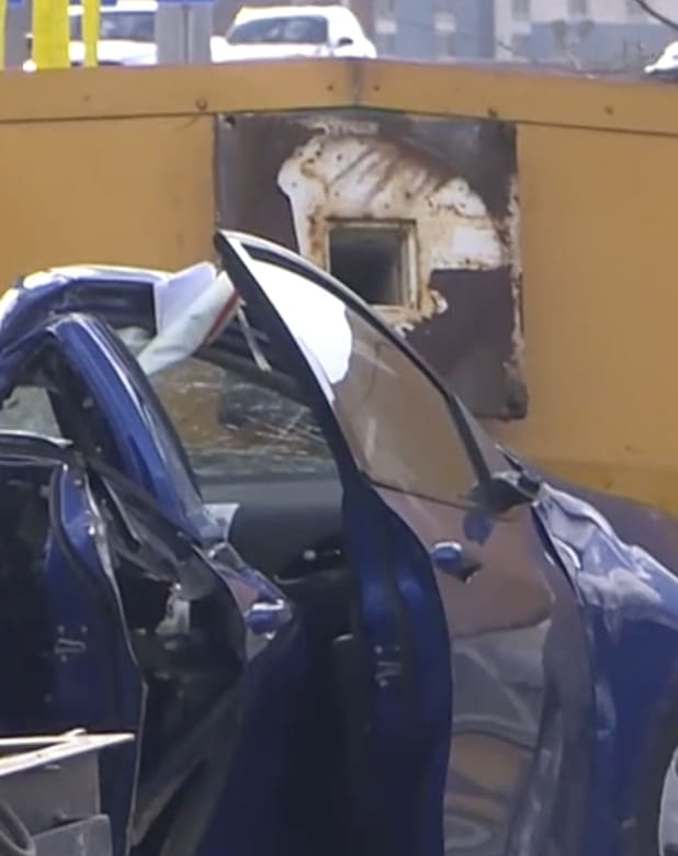

Looks like there are two plates still together.
I see a circle that is likely the outline of the pole.
To me, weld failure.
We can see pretty clearly the "interface" between the sign and the support pole in one of the above photos.
How come it looks like it was glued together? I see no bolts or bolt holes. I see an interesting pattern of rust color and white color.
I am curious who designed that interface.
Welded? Really? Am I missing the alignment pins that would have been used for the operation?

A zoom of the photos shows what looks like 4 bolt holes near the corners of the square. They seem to be not particularly well placed, but I'm not an ME.
The rust pattern is probably from the bolts rusting and loosening over time and wind rocking the sign and allowing water to seep in
TTFN (ta ta for now)
Fatigue crack propagates, sign falls.
It could just be the bolts rusted out; the bottom of the plate looks rusty, so the bolts were likely pretty rusty as well, and there were only 4 of them holding the sign in place.

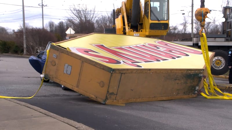

I found some more pictures showing the sign mounting.
Here you can see the empty bolt hole in the upper left of the plate:
And here's a shot showing two remaining bolts still in position as the sign is lifted for removal:

Is that the plate from the top of the post? or the underside of the sign?
Could those bolts have been good for anything but lineup purposes?
Could they and the plates possibly been designed for wind or seismic loads?
For the dimension of the plate, the plate looks a little thin... for any high load conditions.
