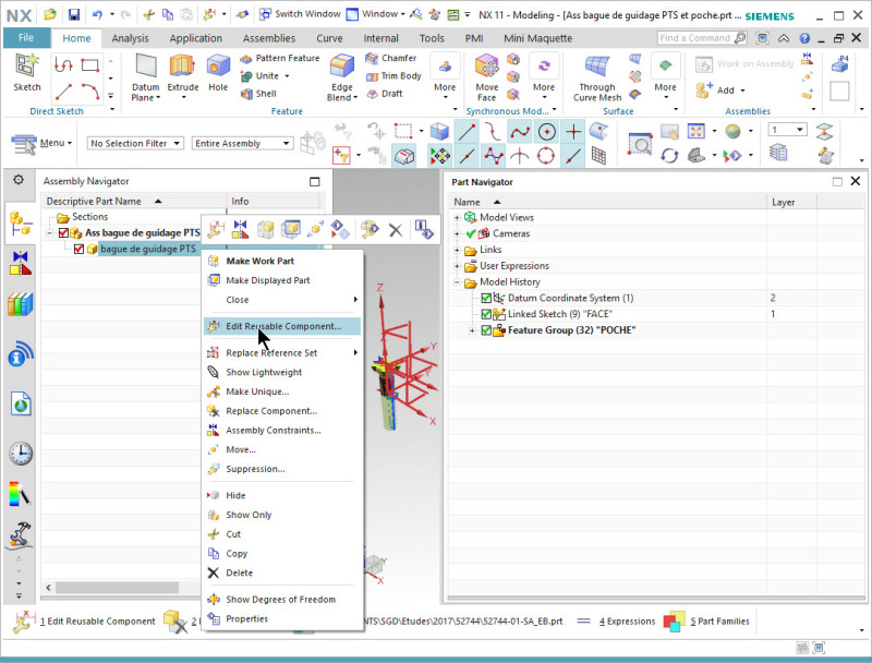

How to delete the PTS included in a Part ?
I founded only one possibility by deleting all lines
But the PTS notion remain
And I have the following error
Thanks in advance
Regards
Didier Psaltopoulos
Somebody in France gave me the solution
We must delete all attributes with PTS_...
Regards
Didier Psaltopoulos
Thanks, Didier.
The other (maybe easier) way is to use "Tools --> Knowledge Fusion --> Remove All Rules". (The Product Template UI is stored inside the part using KF rules.)
And yes, this command is available even without a Knowledge Fusion Author license. (That's often the next question.)

Hi Taylor,
Yeah, thanks a lot
My WA was not perfect because some PTS notions remained in the part under right mouse button (edit reusable object)
Is the ER in progress ?
