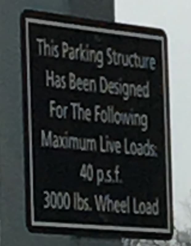

I took this picture a few months ago at an underground garage where the top floor was at grade. It looks just like a regular parking lot, expect for this sign:
Do you suppose every truck driver knows his wheel loads?
Again, so it would appear that there is a disconnect between the 40/50 psf in the code (limits you to about GVWR of 7000 lbs) and what any normal winter maintenance truck would be. So for those of you designing parking structures in cold climates, you're telling owners that they're limited to manual snow removal and/or bobcats and hand spreaders?
It would behoove any structural engineer to find out what loading conditions are intended and/or possible.
The 40/50 psf is applied to the entire floor area (parking spaces + drive ways), while the truck only occupy a finite space at infrequent occurrence, not to mention live load factor.
